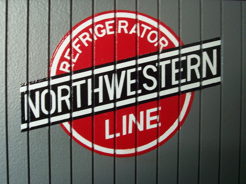

This is a little off topic. I paint my 1 1/2" scale cars instead of using vinyl. The small letters are only 1/8” high. The same shop that cuts the vinyl can cut the paint mask.
Tim

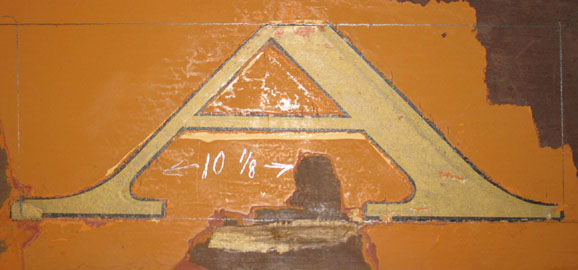

Vinyl has worked pretty well in most cases. I have also hand painted some but our current project requires lettering over wood car siding with a grove between slats. Bob K. mentioned a method of softening a decal to stretch it into the grove. And indeed sanding through the paint proved the original numbers for the car sides was a decal. The file below is from the letter boards that were flat.
File comment: Original letter A probably from the 40s
