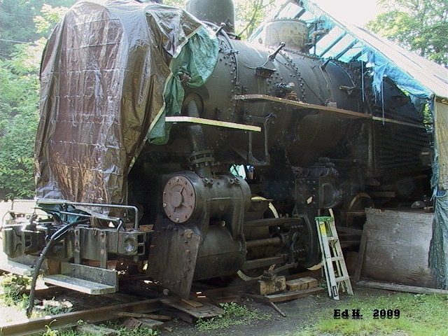

Much progerss being made on CNJ 0-6-0 #113 since my last visit in 1999. Amazing what a small group of dedicated men under a tarp can accomplish!
Ed K. cp Laurel Run
File comment: 7/25/09
Ed K.

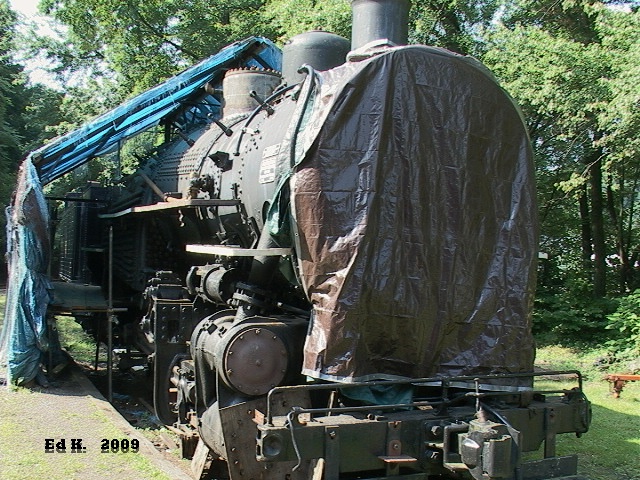

Ed K.

SteveRG wrote:
Any time frame on at least a hydro on her yet?
I believe the hydro was done, a steam boiler test comming soon.

The boiler was filled to the dome with water for the first time today (not counting the first boiler wash) to determine any leaks. It was not put under pressure and there were a number of leaks under the unpressured head of water which need to be addressed. It was nothing serious and what could be considered normal for the first fill.

It is extremely DIFFICULT and SLOW working under those conditions. It is almost entirely affected by the weather and many months of the year nothing gets done at all outside. If we had a shop, this locomotive would have been running years ago. The conditions at the site are at best described as primitive.
A web site was started and I just visited it and nothing has been done except the home page and there is nothing of value there either.

To be charitable and without too much complaining, when the effort to acquire a piece of town land across the street was attempted, absolutely no one was cooperative--the town, the neighbors, no one! To say that they were downright hostile would be an understatement! The locomotive is sitting on leased land, and it is hemmed in by the station. There are several issues with even putting up a temporary pole building here--again, there was no cooperation here either. I'm surprised somebody didn't complain about the current shop tent.

Another hydro test today. After rolling a few tubes, just tiny drips here and there. The boiler is now 3/4+ full and holding.

Is it just me, or does she look like she is leaning towards her left side in the engineers side picture? Could it be that the brown tarp is crooked rather than her?
