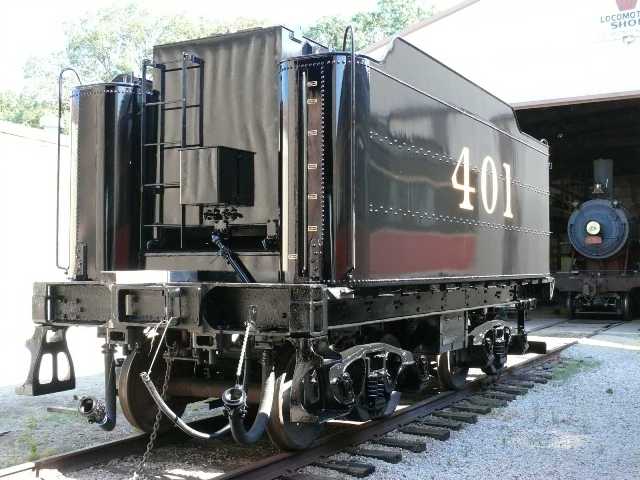

PostPosted: Sun Jul 26, 2009 7:17 pm
Posts: 119
it has had a paint job!
(while the 401 herself looks anxiously out of the loco. shop)
And a beautiful one at that.

That sight glass on the tank is cool!

WOW!!! I haven't seen those pics yet. I think 401 is actually smiling waiting for for her big return!
Well done!

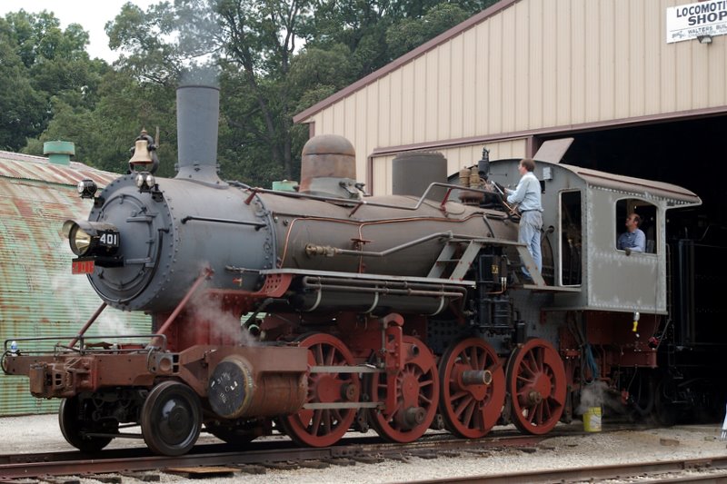

Second test fire. Setting the safety valves in this picture. This was the boiler's first operating pressure steam test.
