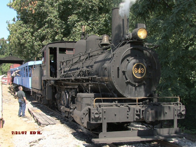

 Post subject: Re: Big Boy #4012 gets a new coat of paint
PostPosted: Fri Aug 21, 2009 11:49 am
Posts: 322
Location: Laurel Run, Pa.
This is the reason the PRR. 643 at Williams Grove runs with out a boiler jacket. She stays outside all her life so rot, and rust won't attack so soon.
Ed K. cp Laurel Run
File comment: B-4 #643
Ed K.
