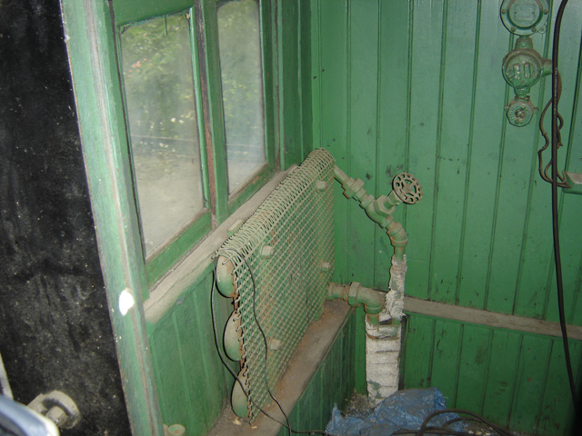

PostPosted: Fri Aug 14, 2009 6:02 pm
Posts: 216
Location: Pittsburgh PA
Here's the interior of B&LE 643's doghouse. Pretty spartan inside, though there is a steam heat radiator against the rear wall.

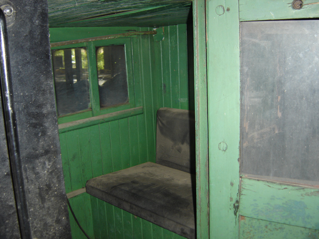

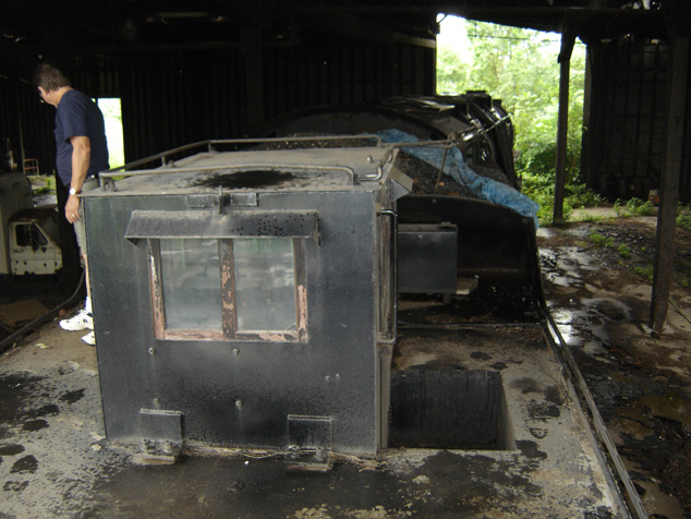

Here are a few more of the dog house on 643

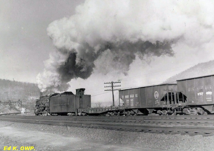

The PRR. Famous for its "Dog house" seen here on a westbound PG-5 at Cove, PA.
Ed K. cp Laurel Run
File comment: PRR. "Dog house"
Ed K.
