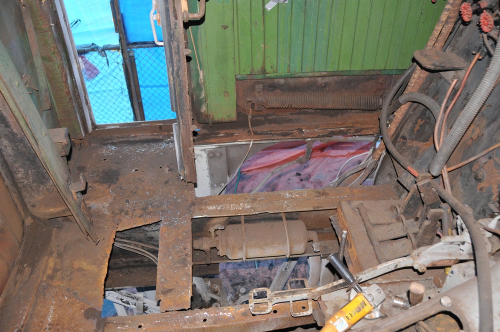

While the floor of the cab was being repaired, we dicovered one of the few remaining remnants of 6167's booster engine mounted on one of the supports for the cab floor, the timing resoivor.

Interesting picture Joe. Looks like your floor was in pretty good shape really. I hate to think what we will find when we pull the wood planks up?!

Well most of the steel floor is being replaced. It (and espicially the wood) was pretty rotted out

Joe, What arrangment do you have where the wood meets the coal doors? I have hears stories of the deck boards running up to the coal doors and then some sort of trapdoor arrangement covering the floor of the vestibule?

On 6167 and 6213 for example, there is a large metal plate attached to the tender on a hinge that channels the coal from the coal gates to the floor of the cab.
On 6167, there are the four main coal gates, and a small door maybe 6' or so high thats mounted on a hinge on one side of the door and lifts up. I haven't seen this on 6213, but I haven't really looked either.
Look at the first 2 pictures on this page:
http://www.trainweb.org/j.dimech/journal/080419-4.html
If you look just below the 4 big coal gates, you can see the smaller plate that lifts up. In the first picture, you can see the plate that sits in the vestibule. Mind you its been broken off its hinges and is sitting in the stoker trough.
Also, if you look at the second photo, you can see the hook that holds the plate below the coal gates, next to the try-cocks in the vestibule.
