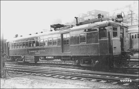

"The "Green goat" was all the rage, railroads and even the Goverment spent lot's of money on them."
I've always been intrigued by the green goat concept.........small efficient genset running at a constant speed trickle-charging the storage batteries. Was surprised recently to read that something similar was used (quite successfully) on CN 'way back in 1925.
An article on CN's "Jitney" is linked below.
http://www.rootsweb.ancestry.com/~onbdhs/jitney.html
