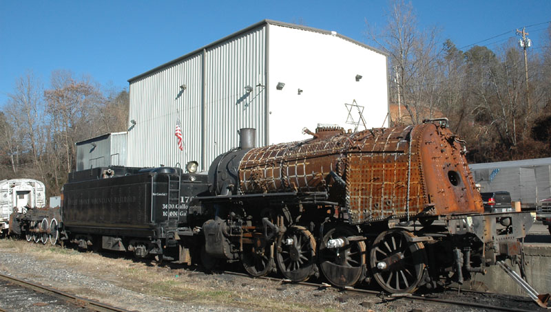

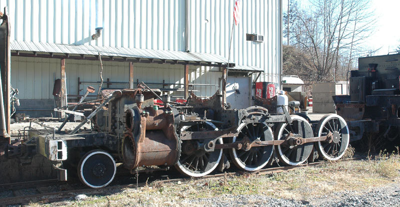

I do not believe TVRM wore out or helped to wear out the 722 during its brief time there in the mid-80s. I may be reading too much into Martin's comment. You can probably assume the engine has a long, long way to go before being restored.
I drove by the Dillsboro shop this past Monday, 11/2. Both the 1702 and 722 appeared to be unmoved and untouched since I was there in December of 2005.
I've attached photos from 2005 showing both locos. I'm not sure where the boiler for the 722 sits at this time.
It doesn't appear the GSMRR is in any hurry to return to steam anytime soon. If they did return to steam in the future, they will probably still need a diesel and crew to help supplement on the return trip.

Regarding the 722's boiler, it is sitting on some cribbing on the other side of the shop. In your first pic, if you could 'move' that coach just in front of the 722's frame and drivers, you would probably see it.

The 722's boiler is sitting on cribbing behind the silver baggage car. At least that is where I left it. Boiler's first course needs a bottom 1/3 replaced, new smokebox, partial front flue sheet, crown sheet, and some other details on the backhead. Running gear would need to be gone through.
1702 needs an entire inner firebox. Running gear is nearly new, with exception of the rings and some bushings on the valve gear. 1702's last running season was 2004. I was hoping to have it back together for part of the 2005 season, but when it came to buying materials. . . . I didn't want to leave her like that but the time came to move on in 2008.
The 722 would be a better engine for the territory, but 1702 is closer to running. Either way, Kenny and the boys have there hands full with the diesels and the coaches.
