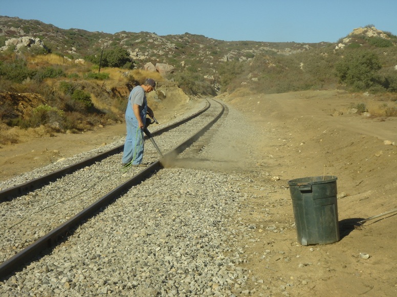

Here's a shot of how we are now dealing with the problem. A couple of our guys have electric leaf blowers. Behind the camera is a speeder and trailer with a 2 KW Honda generator supplying power to the blower. The "debris" is blown away from the ballast, raked up and put in the trash can.
