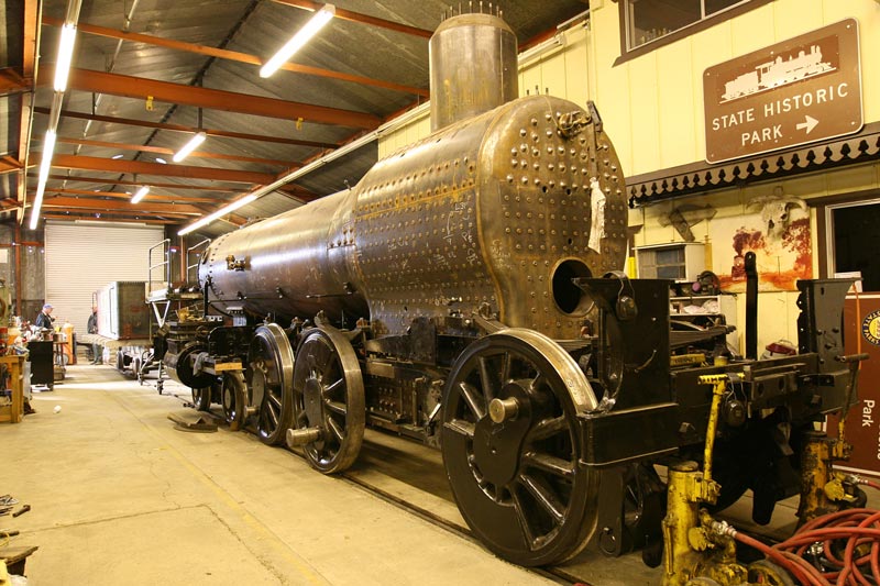

On Sunday, November 29, 2009, Sierra Railroad 3, 4-6-0, (Rogers 4493 / 1891), originally Prescott & Arizona Central Railway 3, was seen under repair in the Sierra Railway's Tri-Dam Building, Jamestown California. The new boiler was manufactured by Chelatchie Boiler Works, Camas, Washington.
Restoration progress can be followed on the Railtown Shop Blog: http://www.railtown1897.com/ -> Railtown Shop Blog
File comment: Sierra Railroad 3, 4-6-0, (Rogers 4493 / 1891) under repair in Sierra Railway's Tri-Dam Building.

Great looking boiler -- thanks for posting!
Stephen

The crown stays on this locomotive, are they all along the vertical axis of the boiler. That is are they all perfectly vertical?

Crown Bar boiler with sling stays.....
