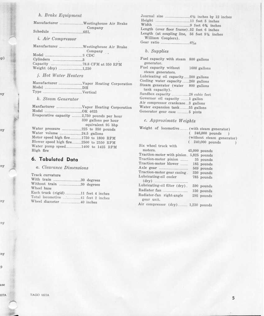

This is from is ALCo GE RSX-4 MRS TM 55-2210-216-10,page 5
The weight for all major part are list.
This unit weight 120 ton an a 244 engine and 2 truck with 3 traction motor on one truck. The GE was the built use the body by ALCo to get a contact with ARMY to supply 83 unit.

Owen,
You made that so small, you can't read it.

The is Page 5 Again.

Much better! Thanks Owen!
