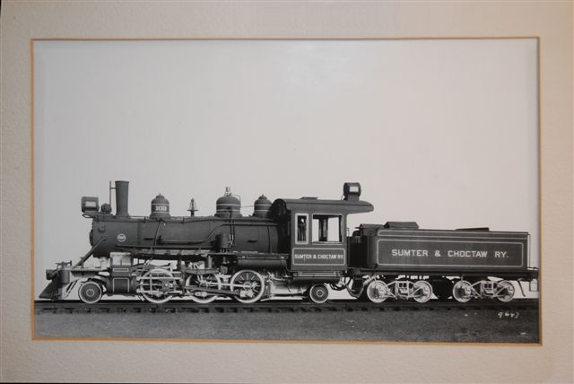

Here's another possibility for some future time:
About 45 tons in working order, capable of 20-25 mph on decent track, 3000 gallon water capacity. And rather cute, I'd say.
Prairies of Thomaston, CT

Is this S&C 2-6-2 the engine that was at the Valley Railroad and owned by the Empire State Railway Museum at one time? Not sure what you know about future plans for the Prairie. Maybe you'll clue us in.
As for future possibilities of this engine being moved by highway from one location to another, I can see one problem; length! The tender adds enough extra length that it would probably need a second tractor/trailer thus increasing costs. If you want a better alternative it would be a 2-6-2 tank engine. I will agree that the 103 is "cute" however.

Take a look back through the briefs section for pics of 103 moving in June 2009. The tender easily goes onto a simple tilt-bed truck. The engine's weight might be a problem, yes.
At any rate, that would all be a long way off.

A locomotive like no. 103 is exactly the type of engine I had in mind. Two trailers would do the trick to move the engine and tender around. As for rolling stock, most museums and tourist railways already own suitable cars, even if it's a string of flatcars with sides and benches or a gaggle of cabeeese. I have fond memories of riding behind no. 103 at the original Empire State Railway Museum in Middletown, NY, as well as at the Valley Railroad in Connecticut. I look forward to seeing the old girl under steam at Thomaston someday -- better yet, visiting somewhere else.

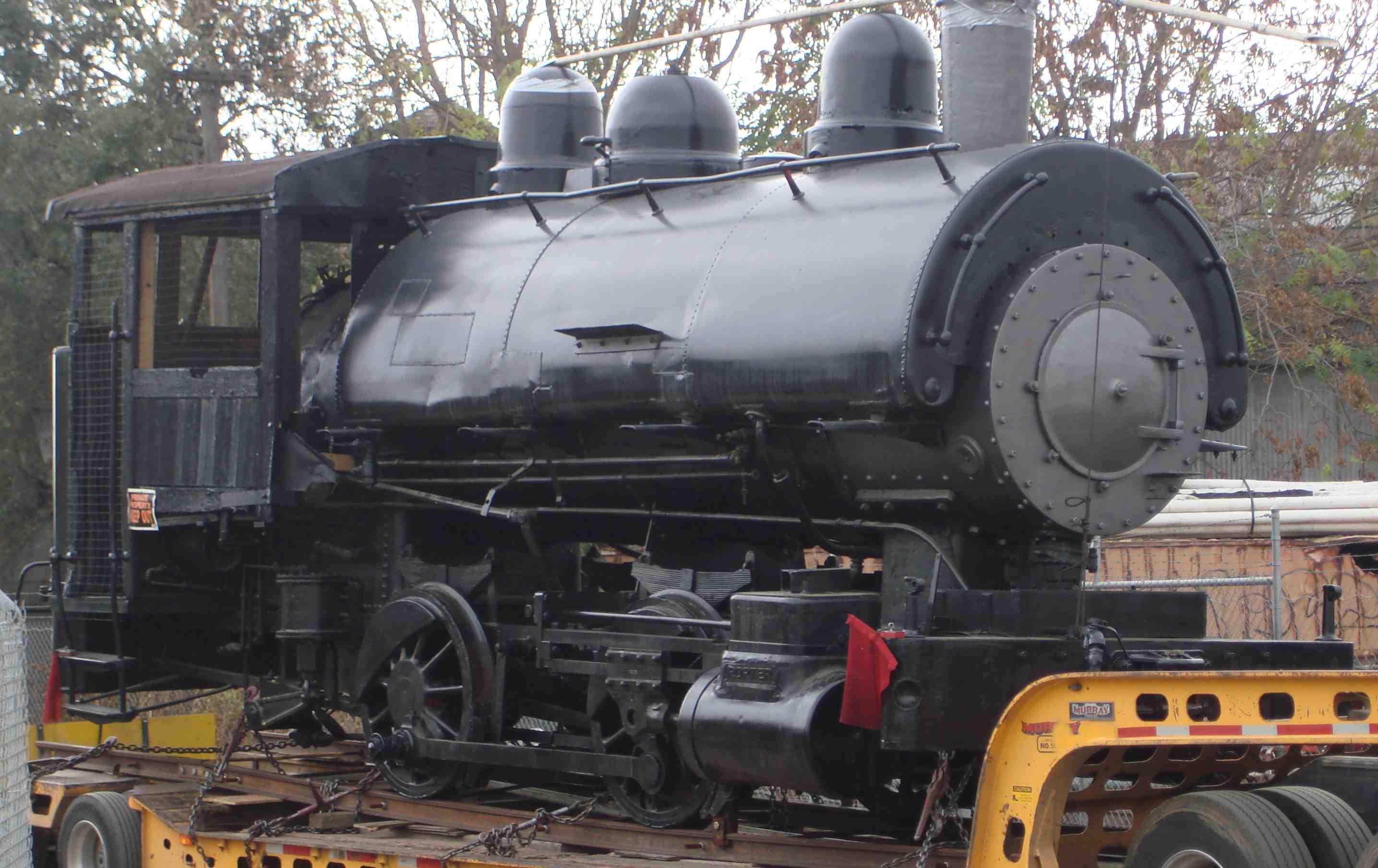

I would agree that it is more economical to move a locomotive simply and less expensively via truck. Tank engines fill this bill nicely as long as they weigh in under major load restrictions. John Gramling's Flagg Coal 75 is a fine example of keeping things simple, cost effective, and being able to reinvest monies into making a sustainable steam program. A traveling engine show is very costly and it needs to pay for the engine's next rebuild in order to sustain itself. Otherwise the business model must rely on personal finance which is by no means stable, or grants which although very helpful, also can be spotty and subject to uncontrollable outside forces.
The reason I say this is because I am in the middle of rebuilding a small engine on the West Coast to do just such a thing. You can see a progress update from the beginning of December at:
http://www.trainorders.com/discussion/r ... 10,2083532
After doing much careful research, it is very clear what is possible and what is not. As Doyle McCormack has said repeatedly "these things run on money!" and a workable business model is key. For my engine I do not intend to make profit from the operation, merely be able repair and rebuild when the time comes. Luckily, when the pressure vessel work is done, that should not be an issue for decades to come. I have also included a photo of the locomotive before restoration began which illustrates the portability and feasibility of road transport.
For all those becoming interested in traveling engine shows, I truly believe this will become an ever more important aspect of the steam community, and applaud the efforts of the Gramlings for starting this new chapter in small steam.
Best,
Stathi Pappas
