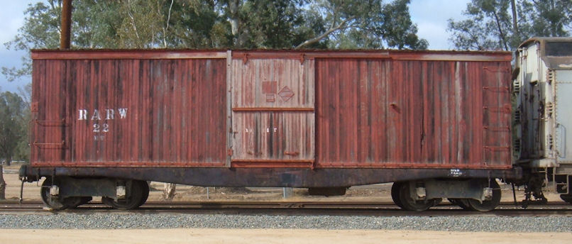

Pictured below is the new addition a former Butte, Anaconda & Pacific box obtained (purchased) direct from the current successor operation.
File comment: Side View

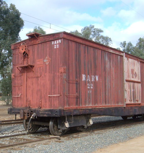

And here is an end view of the car
File comment: End View

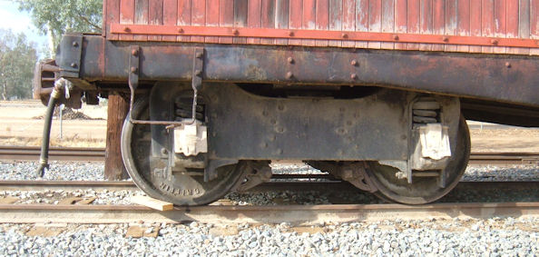

And here is a close up of the truck. Is this a Fox truck or a similar style?
File comment: Close up of the truck

 Post subject: Re: New (old) box car at Orange Empire
PostPosted: Mon Dec 07, 2009 10:12 pm
Yes, those are Fox Patent trucks on the BA&P car. A very nice additon to your collection, congrats!!

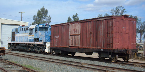

PostPosted: Mon Jan 25, 2010 10:27 pm
I thought I'd post the following photo as it shows the relative size of the 1906 box car compared to recent motive power:
File comment: BA&P #22 in front of Car Barn #7.
It is coupled to one of Orange Empire's ex-SP ALCO RSD12 locomotives. Two of these 1800 hp locomotives were later used at a coal export terminal at Port of Long Beach (CA) prior to joining the collection of OERM.
The photo was taken on Sunday January 17, 2010.
PostPosted: Sat Jan 30, 2010 4:20 pm
Posts: 969
Nice save. Hard to believe some of these cars managed to make it this long with the original trucks under them. I remember helping with unloading the Mid-Continent car back in the 70's. The car was in decent shape for as old as it was. M-C car had a piece cut out of the side frame. I had bent up some some plate to repair it with. Someone else did a better job and did a nice repair job. While looking for something unrelated I found the piece of steel I had bent up a couple of years ago. Still inside of the box car after all these years! M-C car shop guys do nice work don't they? Cheers, John.
PostPosted: Sat Jan 30, 2010 4:50 pm
My understanding is that these cars were used in captive service hauling supplies, such as explosives, to the mines. As such there was no need to replace/upgrade the trucks. But the company did upgrade to AB brakes; probably to simplify repairs and part stocks.
We are talking about both returning the car to an earlier paint and lettering scheme and to restore the KC brakes. In the meantime, the car is destined for covered storage in the building seen behind it and the diesel.
