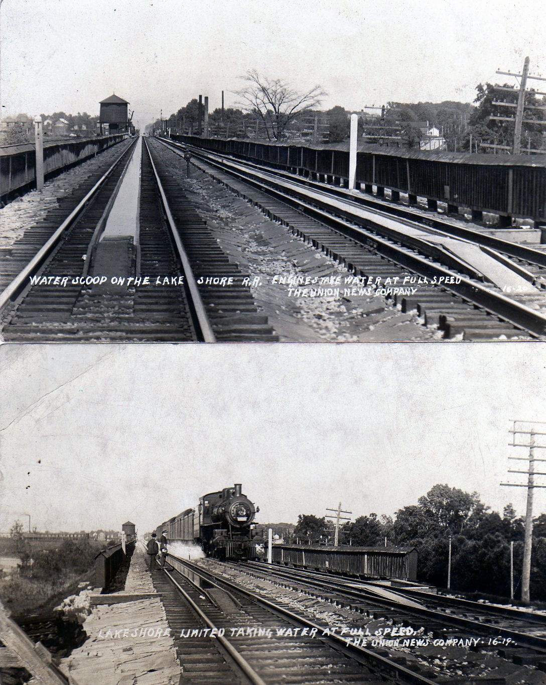

Now that the subject of track pans has come up and not to stray away from the original question of any being preserved.What year were they first installed on the either the LS&MS/NYC or PRR? Also what were the locations and exactly how many were there on both those 2 railroads? Where they used right up to the end of steam on both RR's or were they discontinued before? I know that Huron,Ohio had one and have heard of and seen a few pictures of some others on the NYC over the years but never really knew much of the history of them.
In one of the old telegrams i have from the Norwalk,Ohio LS&MS shops from May 8 of either 1895 or 1899 it mentions the RR wanting to send engine #597 to Huron,Ohio the following day for a test.I alway's wondered if it wasn't to test the track pan there? But didn't know if they dated back that far?

I've attached a scan of a Lake Shore track pan from 2 old photo postcards i had dating back somewhere around the 1910 time period? I'm unsure of the exact location and year as they are unmarked and have no postmarks,but i'm guessing these might be somewhere near Elkhart? Looks like it's by a bridge over a river.I know Huron's was near the Huron river there but don't think these photo's are at Huron,Ohio.Anyone have any idea of the exact location? Where tracks pans placed at river locations due to a good water supply?

quick check off MR mag search, Maine Central had pans, great western had them (web search.
http://www.michiganrailroads.com/RRHX/W ... onMenu.htm
somewhat definative locations of track pans. Might help on the pics (Chesterton?)
