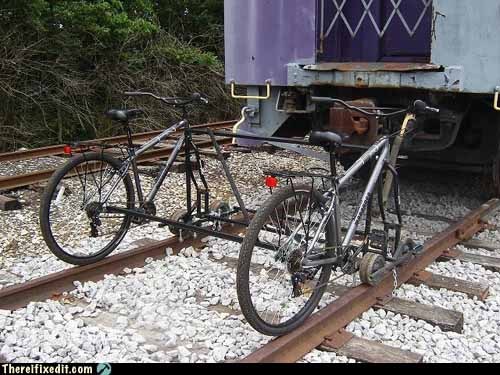

Looking at the V8 powered steam locomotive what are some of the better railroad "kludges" you've seen or heard about? For starters I submit one of my own creations that (for a very short period of time) served as a track inspection vehicle.

Interesting bike. Couple of questions.
It appears you used flat wheels for the front, and then even smaller wheels running against the gage face. How well did that work, especially in areas with significant metal flow?
How well did the rear wheels track?
Would it work with only one rider, or did both bikes have to be pedeled?

The front wheels are common push lawn mower wheels with internal roller bearings double stacked for extra width for better tracking. Those very small inner wheels you see are actually fan shaft roller bearings mounted on 1/2 inch all thread with locking nuts. All of which are found in the hardware section of any Lowe's home improvement store.
The use of the fan shaft bearings works quite well and I've actually found if both riders come close to syncronizing speed only one or two bearings will actually make contact with the rail. However you are correct in that they do tend to catch on rail where the railhead has experienced "flow" and has mushroomed out. However I took that possibility into account in the design and the all thread shafts the bearings are attached to are actually movable and can be raised and lowered to make the contact with the rail face in the best possible spot on any size rail and will slide underneath any flow material.
However I have discovered that these bearings tend to make alot of noise and plan on replacing them with roller blade wheels this summer.
The rear wheels actually track alot better than many people think and I'm regulary asked this question about it. The two bicycles are actually bolted tightly to the frame when the rig is fully assembled. The way the roller bearing are gauged and spread out dosen't allow the frame to twist side to side very much and therefore the bikes are fairly rigid as well. The addition of the connecting bar you see connecting the back of the bikes together and the cross arm attaching that directly to the frame almost eliminated any side to side motion all together.
However the rear wheels also don't have anything built into them to compensate for poorly maintained track, especially on light 90 pound rail like in the picture. It performs very well however you can expect for one of the tires to slip off every so often if the track gauge is poorly maintained. On 135 pound rail it has always performed flawlessly and my cousins and I have wound this thing up to a pretty good clip without feeling hesitant on well maintained track.
The bike also works with one rider. However it does track better with two riders since it obviously would want to twist less with power input from both sides. However I have pedaled the contraption on a ten mile trip by myself without any major problem. I will admit that with the weight if this thing having two riders is alot easier:)

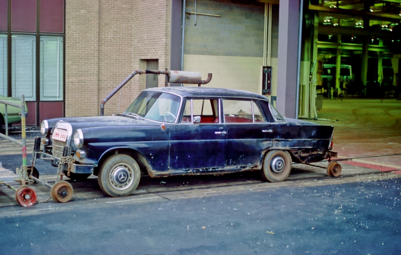

I always liked this "prime mover" used by the standpipe installation contractor on the original Washington Metro subway. It's diesel because gasoline engines were not allowed in the tunnel. Others gave him a hard time about it, but he replied that he was the only contractor with air conditioning and am/fm radio!

Some slick tires rather than the knobby mountain bike tires would probably work even better with that railbike setup.
