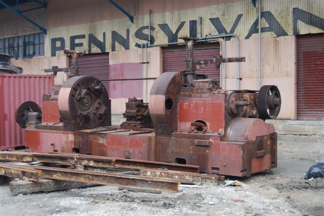

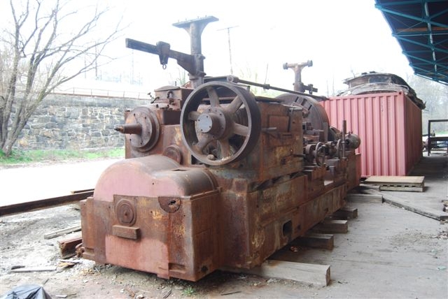

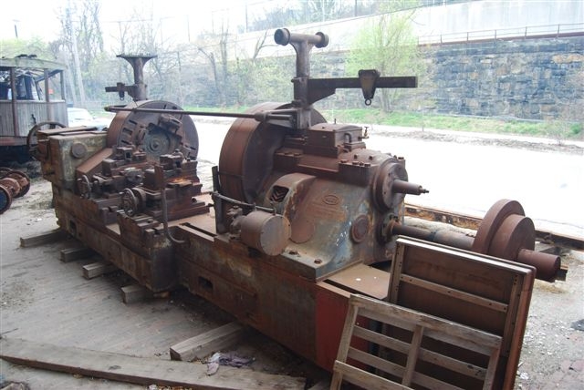

As promised.....
Dimensions: ca. 28' by 8' wide by 10' high; the top brackets should come off, reducing overall height to ca. 7.5'
Weight of 60 tons is what was cited to the Museum by the haulers/crane operators the last time it was moved, ca. 1980. All controls, motors, etc. have been in indoors storage since its relocation then.
As is, where is.
File comment: Note shipping containers next to lathe, for scale

The deck roof came from half of a permanently-coupled car set which had been used as a diner in Glen Burnie, MD. The PC sets were created from open cars that had been sisters of open car 1164 in the collection. Bits and pieces are stored within the container and inside the freight shed.
The lathe was delivered to BSM approx. 1980 when the Canton Railroad's shops were being relocated/demolished to make way for the I-95 tunnel under the Port of Baltimore. A large excavation of the floor inside the freight shed, now filled in and re-concreted, was to be the indoor site of the wheel lathe.
Dave Crow

Was Simmons Machine Tool Company of Albany, NY, contacted as a potential buyer of this machine? SMTC is the current owner of Niles Tool Co. and is always looking for used WL52 machines such as this one. My contact there was Dennis Rymanowsi but it's been awhile since I last spoke with him. A quick check of their website stays that Mr. Walter Fluhr is now in charge of Railroad Machine Tool Parts. Someone should call (518) 462-5431 and see if SMTC has an interest. I hate to see any of these fine machines cut up. There won't be anymore built.
G. Mark
TVRM Wheel Shop Project Director
(can you believe it's been 10 years now since we finished rebuilding our AW90 Heavy Duty 90" Driving Wheel Lathe?)

G. Mark, have you worked with Simmons Machine Tool to source any; parts, service or OEM information to help with your 90" Niles?
I believe the stats on this size Niles are;
52" max. Wheel Dia.
26" Min. wheel Dia.
10' 5" Max. Distance between face Plates

Loco112 - Yes I did. We developed a strong working relationship with SMTC during the restoration period of all three wheel machines. We received support with drawings (we did pay a small fee for duplication charges) and technical information. With just the serial number, I was able to obtain Sales Memos which contained all the details of the machine including date of order, purchaser, date of delivery, cost, and any special ordered equipment. We also had to purchase some parts from SMTC which they were able to supply from original patterns or drawings.
G. Mark

I found a new stat on that 54" Niles;
Distance between faceplate;
Minimum ………………….6’ 10"
Maximum …………………10’ 5”
