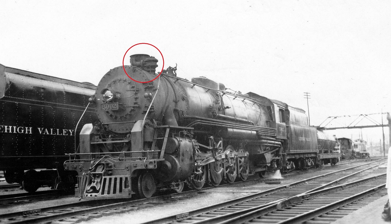

Just curious...What is the appliance circled on this picture of a Lehigh Valley 4-8-2 engine #5002?

Turbocharger? (just kidding...)

I don't think it's a booster exhaust such as the NYC would use; this 4-8-2 has a fabricated trailing truck, so I wouldn't think it has a booster. I'm guessing it's some sort of muffler, perhaps a centrifuge separator of some sort. But what is it for? The engine looks to have an extended smokebox holding a Coffin feedwater heater--yet the water pipe leading to the check valve is coming from the rear, such as it would with an injector (non-lifting in this case).
Is it the separator and muffler for some sort of continuous or automatic blow-down device? Did the LV have water problems like the Santa Fe, which extensively used such appliances?
Good looking steam power? Indeed. It's a shame the LV didn't save any of it.
Any Lehigh Valley experts here?
A PS about the looks--seems the LV had a lot of Alco and New York Central elements in its designs; that drop pilot, those air compressor shields, and the smokebox front and door with the centered headlight and no bell would all be right at home on a Hudson or a 3000-series (L-3?) Mohawk. Nice straight running boards were a classic touch from both as well, at least on as-built locomotives. The 4-8-4s the LV had (Wyomings, for a county) looked more like classic NYC engines than the Niagaras the NYC actually got!

It's a "Locomotive Automatic Draft Control" device. You can find an advertisement for it on page 335 of the 1941 Locomotive Cyclopedia. The locomotive in the advertisement also appears to be an LV 4-8-2.
The manufacturer claims the device limits the exhaust backpressure and therefore the draft by allowing exhaust steam to bypass the nozzle and stack when the backpressure exceeds a pre-set value. The manufacturer claims it functioned in the high power output ranges and reduced waste of fuel and allowed grates with larger air openings.
I have no idea how well the things worked but I don't recall seeing them on photos of any other locomotives.

Well that was an interesting sidebar, but can we get back to the original question? I, like the OP, am interested in what this appliance was and what it was supposed to do. Since I have never seen another photo with the this device, was it an experiment? Did any other roads use it? It is also interesting in that it kind of dovetails into the discussion about front end design, drafting and Lempor exhausts.
I know there are steam techno guys out there who will have the right answer. Anybody?

The question was answered in the 4th post of this thread.
