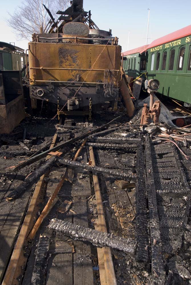

Here is a photo of the damage.
It looks worse than it is. The cab roof and boiler had been removed last year. The boiler is in the shop and the cab roof is stored on top of a car on an adjacent track.
The water tank and cab sides were clearly damaged and have to be replaced.
A lot of the fireman's tools were warped by the heat and also need to be replaced.
This photograph was taken from the roof of boxcar 62 which was also damaged.

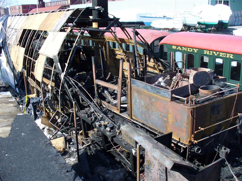

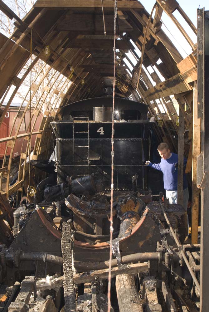

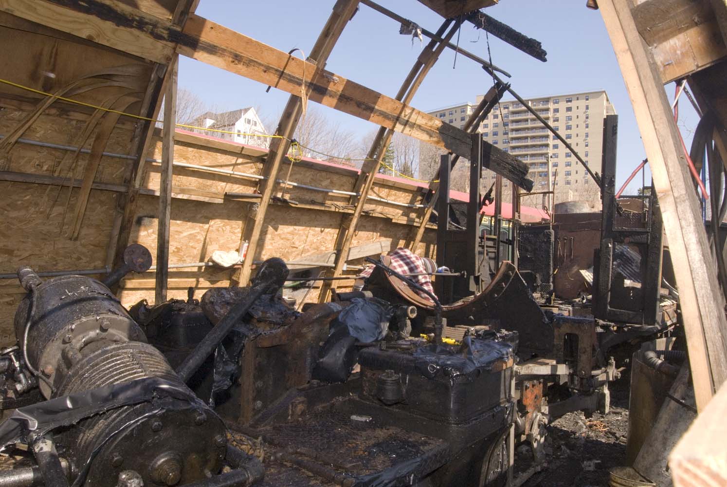

Some more photographs of the fire damage, courtesy of Donna Mitchelson.
File comment: Photograph by Donna Mitchelson. Used by permission.
