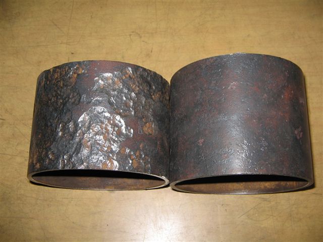

Of most note to me, the meeting began with a wonderful presentation by two highly respectable metallurgists. I do not have the names of the two men other than Don and John. The two retired steel foundry employees lead an outstanding discussion related to why certain make-ups of steel are less prone to corrosion and what make-ups of steel are more prone to pitting and corrosion.
Robby P. could have added greatly to the conversation as from what I understand, Robby is a well educated metallurgist. It would have been interesting to have had additional commentary.
Strasburg brought in a set of tubes that had been installed not more than 5 years ago in some cases. Some of the tubes, of the same locomotive had very heavily pitted tubes, while tubes located next to other tubes had zero pitting! The question to the experts was….What is it about the two tubes that causes one tube to pit and the other to remain whole, when located in the same boiler!
Without re-hashing the entire discussion, the conclusion offered by the experts was that the copper and other “tramp” elements included in the tube are contributing factors in respect to how the tube responds to corrosion.
We may ask Kelly or Rick or even Linn to post a few pictures of the tubes so we can all see the items.
G. Mark Ray was appointed to head a task force that will review corrosion contributors to try and offer a more isolated answer as to the primary corrosion contributing factors related to steel composition. Be it made very clear that the entire body, (committee and gallery) agreed that oxygen is the primary cause of corrosion. The question on the table is; how do individual make-ups of steel react to specific amounts of oxygen. I would encourage anybody here to contact Mark Ray if they have a desire to follow this project.

Per John’s request, here is a sample of the corrosion issues we are dealing with. These came out of #31 and were put in the boiler at the same time. They are both SA-178-A with a 5 ½” OD and .165 mw. The only difference between them is that they have different heat numbers with means different chemistry and physicals. The uncorroded one has higher amounts of corrosion resistant elements such as Nickel, Copper, Chromium, etc and we do employ a very strict water treatment program. The maddening thing about this subject is that the specification for SA-178-A (along with many others) is so broad; you can end-up with vastly different make ups and still satisfy the specification. In other words, it is a crap shoot with what you get unless you are able to specify how much of the anti-corrosion elements you want and still satisfy the specification. Typically, you will have to order a mill run to accomplish that.

#31 is superheated???
