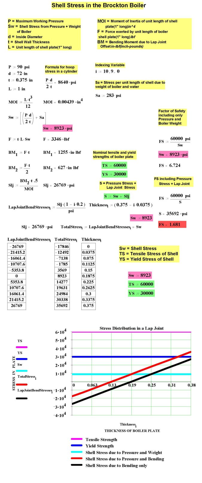

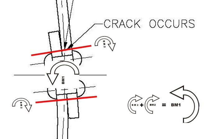

Please refer to "Lap Joint Math" for bending moment calculations.
