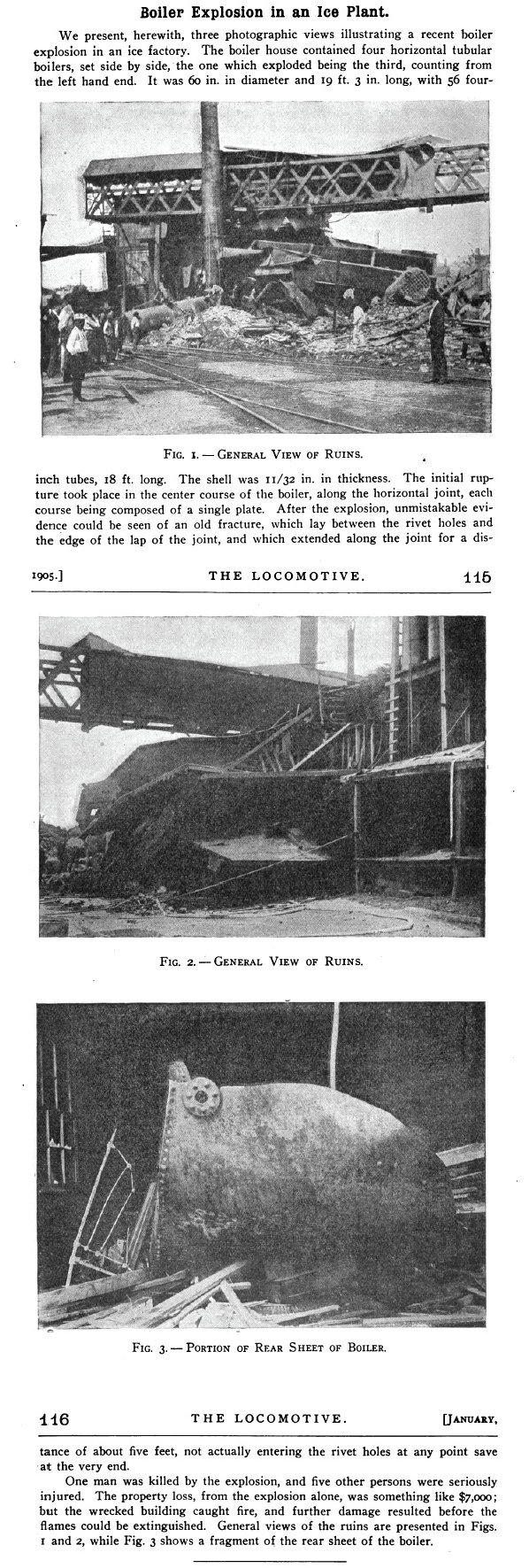

From Hartford's "THE LOCOMOTIVE" Jan. 1905
"After the explosion, unmistakable evidence could be seen of an old fracture, which lay between the rivet holes and the edge of the lap of the joint, and which extended along the joint for a distance of about five feet, not actually entering the rivet holes at any point save at the very end."

The reason most state boiler codes either prohibit or are very restrictive of unreiforced riveted longitudial lap seams in barrel courses was because of the problems with longitudial cracks developing inside the joint. These cracks were hid so the crack could develope until the joint failed causing explosions. One of the methods developed to inspect this area was to cut a V-notch between the rivets so the the hidden area of the opposite plate can be inspected. I have seen a few lap seam boilers inspected this way it does not effect the tightness if properly caulked
or strength of the joint.
I once worked on a very old lap seam boiler we were inspecting for possible operation and had a X-ray company come out and inspect if we could Gama-ray the lap seams and look for this type of longitudial cracks. The operator told me that because of the films being on top of the rivits it would be difficult to get good films But if the film was positioned without the rivets we could get a good job. Never did it. project was stop for other problems.
Has anyone had experance with shooting lap seam joints and looking for cracks with good results?

Dennis: I think there is a way to fully x-ray a lap seam. It should take two shots, one of the two plates, and the second under the rivet heads. The result is an underexposed rivet area on the first, and an overexposed plate area on the second. The A.S.M.E. Code section V should offer some details as to how this is done. Matt A., have you done this, and can you provide any insights?.

Would Shear Wave be appropriate?

Virginia uses shear wave. To date, no lap seam cracks have been found.
