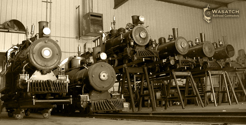

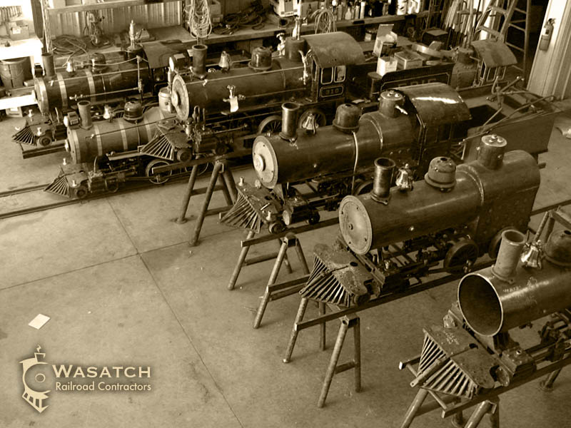

Mike Lewis will be posting a picture tomorrow of how we have put our money where our mouth is. Take a look;
John mentioned that I would post examples showing how Wasatch Railroad Contractors (WRC) has placed it's money where it's mouth is. Here they are:
You will notice, if you look closely that one of these pictures includes not six, but seven (7) 15-inch live steamers, all circa 1900-1911. (See if you can find the seventh...) All of these are in various stages of getting new boilers at WRC.

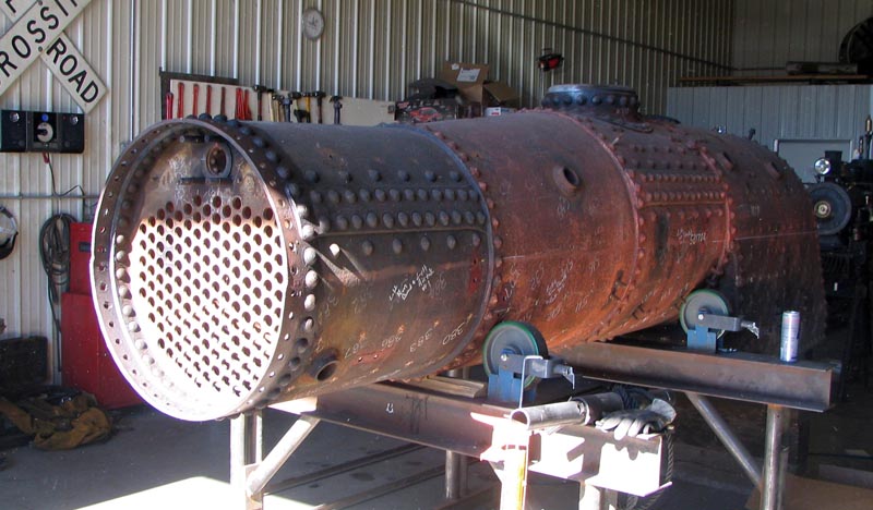

That is not all. We have on order for other customers four (4) vertical boat boilers and look at this:
This is the (old) boiler from Swanton Pacific Railroad No. 1913. The new boiler, expected out by the end of the year, will replace this original.
