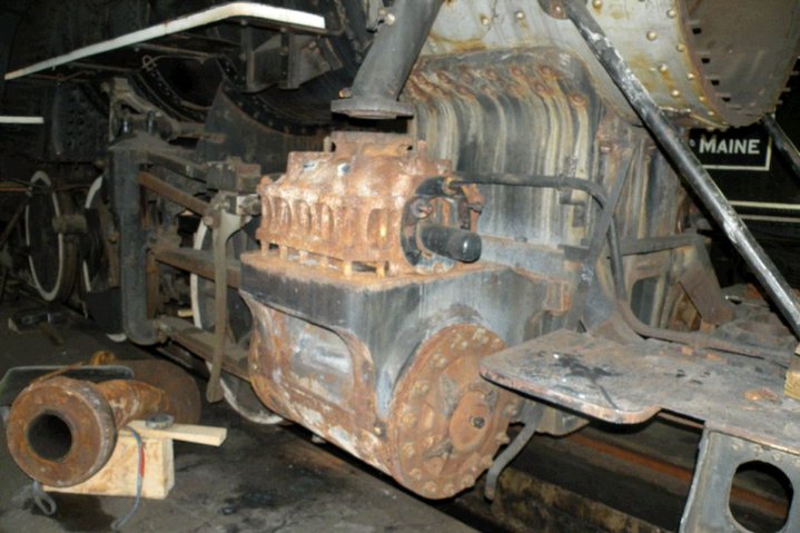

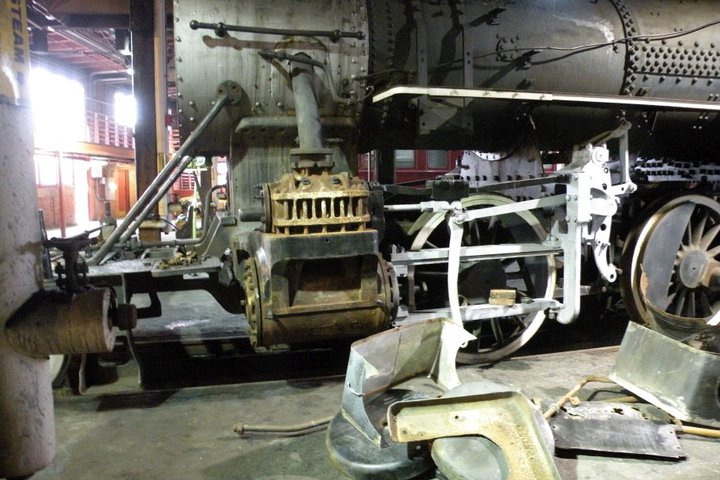

The contractor finished removal of the asbestos from the cylinders! One more hundle completed!
26449_409879579133_133629534133_5035410_1046843_n.jpg [ 74.73 KiB | Viewed 8392 times ]
26449_409879649133_133629534133_5035412_901511_n.jpg [ 92.91 KiB | Viewed 8387 times ]

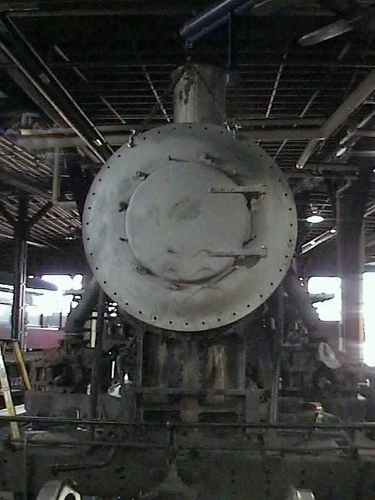

Len and guys test fitted the smokebox cover on the front last weekend. They have to replace several of the studs that are bent. But she looks much better with her smokebox cover on! Enjoy!
