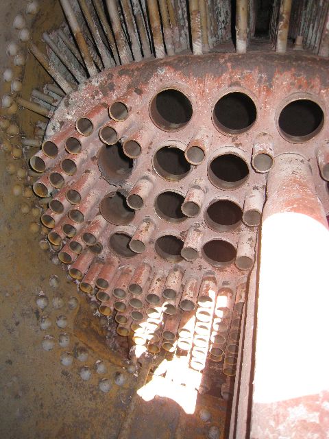

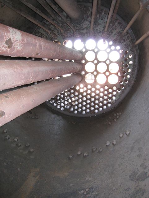

Since there aren't many pictures from inside a locomotive boiler, I figured others might enjoy and/or benefit from seeing a few :)
The interior of the Coos Bay #11 (2-8-2T) boiler after it'd been sandblasted earlier this year.
Look at H2O side of rear (firebox) tube sheet). That's the throttle rod/linkage at the top center of the picture. We had to unwillingly cut it in the process of getting the throttle out (loooooonnggg story) going on the thought that that rod is easily replaced. Especially since we now have the blueprints to the engine :)
File comment: Inside the boiler looking at the water side of the firebox flue sheet.
Similar view showing more of the ends of the cutoff 2" flues. We used a flue cutter on the majority of them (160+). Was a definite learning experience !
File comment: Another view of firebox flue sheet (H2O) side).

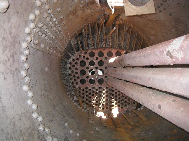

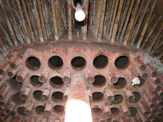

Looking towards the front (smokebox) tube sheet. You don't realize how many tube sheet stays are there till ya get up close and personal ! AND this is not a large engine.
File comment: Sandblasted boiler innards looking towards front (smokebox) tube sheet.

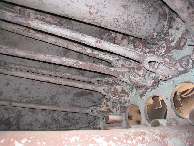

Closer view of the dry pipe and front tube sheet stays.
File comment: Closer view of the dry pipe and front tube sheet stays.

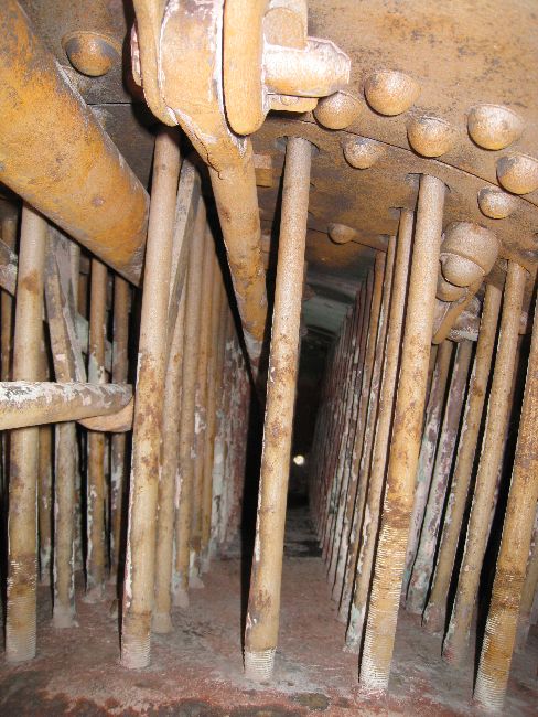

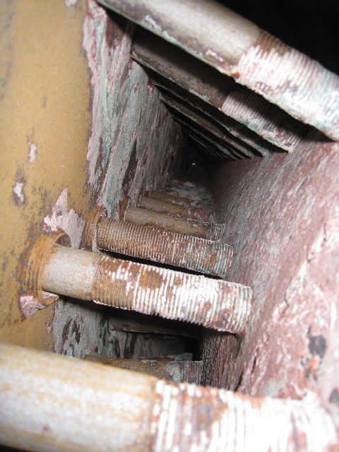

Firebox corner and staybolts.
File comment: View of firebox corner and staybolts

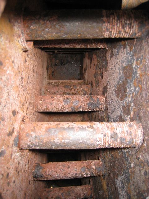

Firebox sheet to boiler shell staybolts.
File comment: Firebox sheet to boiler wall staybolts

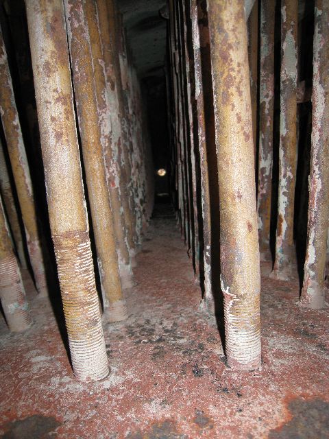

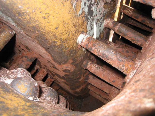

More firebox staybolts. On the left hand side of the picture, the extra threads that are sticking out of the boiler wall (firebox sheet is on right) surrounding the staybolts are actually the flexible staybolt "cups" in which the staybolt head can align itself to the curved shape of the firebox sheet. Also as the firebox heats up the sheet will tend to expand, so this arrangement allows the bolts to move a little bit as the sheets move. (Hope I got the right ! I'm certainly no expert :D )
File comment: More firebox staybolts
The crown sheet (i.e. the roof of the firebox) showing a number of the crown stays. The light at the end of the "tunnel" in the center of the picture is from a removed boiler washout plug.
File comment: This is the boiler crown sheet, or in lay man's terms, the roof of the firebox.

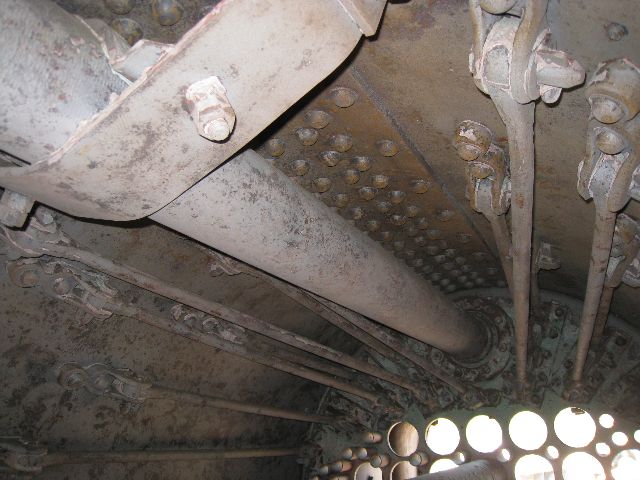

Closer view of front sheet stays and dry pipe that runs thru the front sheet into the superheater header.
File comment: Another view of front sheet stays and dry pipe.

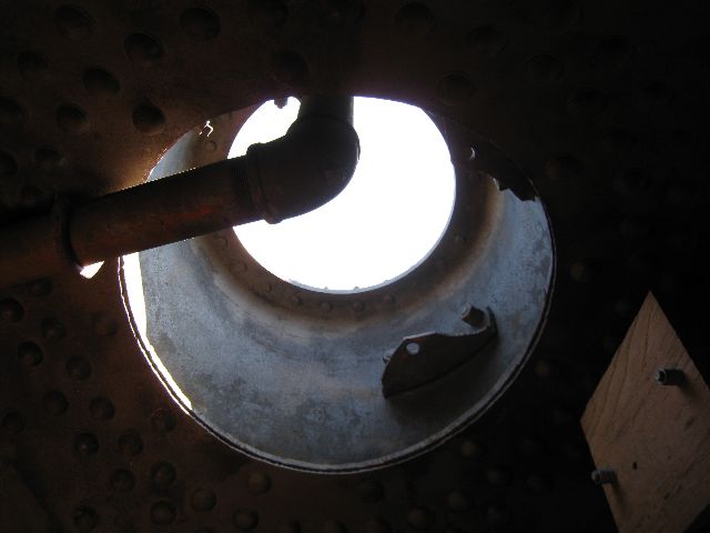

I see daylight ! Looking up into the steam dome. Most of the time the pictures you see are looking down into the boiler from the outside. The flange near near the center/bottom right and slightly visible at center/upper right are where the throttle sits. The board on the bottom right is covering up the throttle dry pipe connection (didn't want junk/grit/sand to get in while it was being sandblasted. The pipe in the upper left is the steam pipe to the steam turret in the cab that supplies steam to the various appliances.

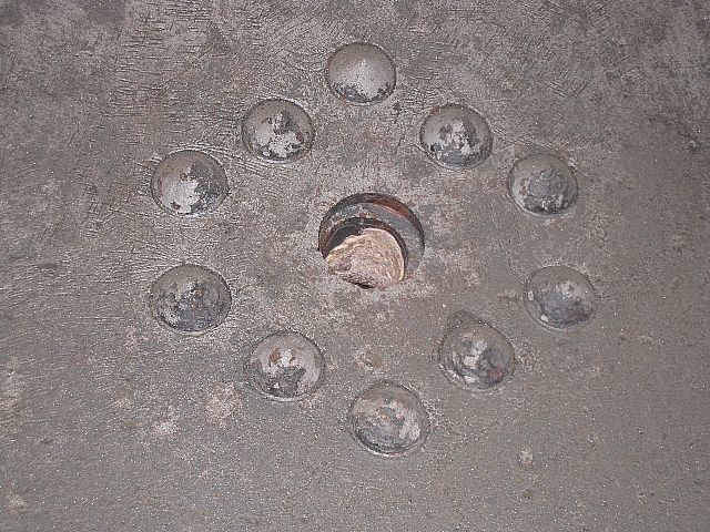

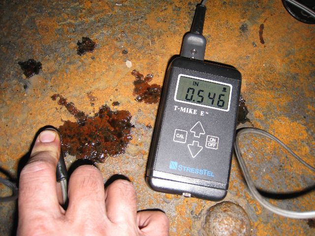

Here's me using an ultrasound meter to take a thickness measurement of the boiler barrel. You need to use some sort of "couplant" between the ultrasound probe (beneath my index finger) and the material you are testing. This liquid (using oil here, there are many different couplants, even saliva -ask me how I know ....) "couples" the sound wave from the probe to the metal. The thickness is determined by how long the sound wave takes to reflect from the other side of the material back to the ultrasound meter. i.e. how fast sound waves travel in a given material. The meter need to be calibrated for the given type of metal, here it's the boiler shell, some sort of steel mixture. Yes, there are much fancier meters with nice graphing display. I completely lucked out and found this one on eBay very inexpensively. In fact it's the same model that Dave Griner showed us when he came out 2 years ago to do a quick check on this engine's condition. I'm sending it in to get calibrated as we speak.

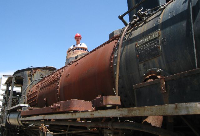

Yours truly playing groundhog with the steam dome :P

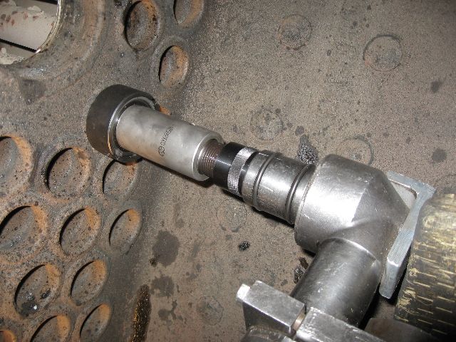

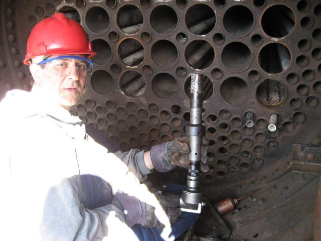

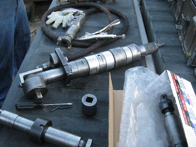

Tube cutter - 2"
Pneumatic drive for tube cutter
Tube cutter ready for use.

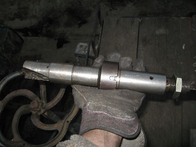

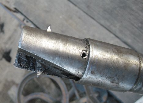

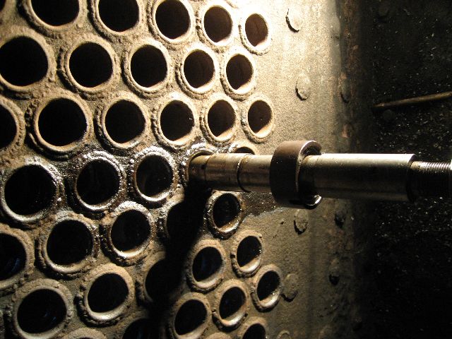

Business end of the tube cutter. These tips are very similar to a lathe cutting tool. The more pressure you apply to the collar on the tool, the farther apart the tips spread, thus cutting wider (deeper) into the tube wall.
Whole shebang inside tube.
The cutter tips are about 6" inside the tube. The tips rotate, cutting the tube from the inside out leaving a beveled edge, lots of lubrication required. As mentioned above, the more pressure you apply against the tube, the farther apart those cutting tips spread, the deeper they cut into the tube wall. If you get a good rhythm going with sharp cutting tips, and plenty of cutting oil, it'll cut thru the tube in about 10 mins or less. It can take longer with dull tips (can be resharpened on a grinder), lack of lubrication, cutting swarf getting in the way, not applying enough pressure on tool for cutting tips to dig in, insufficient air pressure (not enough torque on drive, RPM's too slow), etc. So takes a bit of practice.
