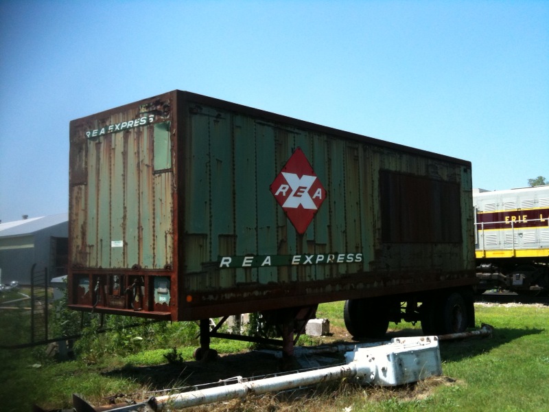

One of our members is working on the restoration of a semi-trailer at our museum. He is unsure of the color of the roof. White? Silver? Gray? Or.....? Anyone know for sure?

Les.. ( and the group ) ..
thought you wouldn't mind if I posted the REA semi trailer at North Judson that I beleive you mention from my recent visit... Sincerely appreciate the hospitality during my most recent visit with you and your group, and I really must say if you have not taken the time to visit with Les and the group in North Judson while in Chicago ( or in the area ) , it is something that is absolutely worth the short drive...
thanks again Les....
Dean Levin

Dean -
Thanks for the very kind words.
Yes, this is the REA trailer that has been moved into the Shop building in the background of Dean's photo, and which HVRM member Tom Travis has begun restoring.

Sooty black from the exhaust of the tractor is all I've seen. You probably won't go wrong using aluminum trailer roof coating for heat reflection and longevity on top where it won't be visible, and run the basic side color right up to the edge of the top.

Thanks to all for the infomation on the REA trailer. Dean thanks for posting the REA
picture. The bottom half of the trailer has been wire wheeled and primed. The REA
signs are coming off and polished. The signs have baked enamel lettering and just
shine up real nice. I have 2 side doors that need to come off the trailer and totally
rebuilt. The rust comes off real easy and I've got a couple of good spots for the
green sides. Some surfaces need to be covered over, as one spot had a fork lift
pierced the end. Some metal work needs to be done where rust has completly ate
away the metal. The rear fold up door needs work, it won't stay up, springs may
be detached. I have not looked at the top, but I was thinking aluminum trailer
paint is a good idea.
