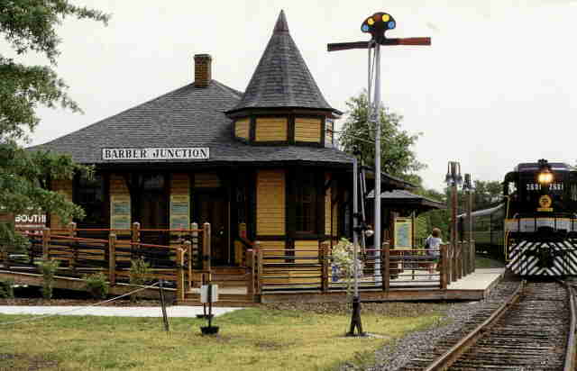

I'm not sure if we have drawings, but there is a similar semaphore on Barber Junction Depot here at the NC Transportation Museum. A tape measure for scale and a some photos and you should be off to a good start.
John Bechtel

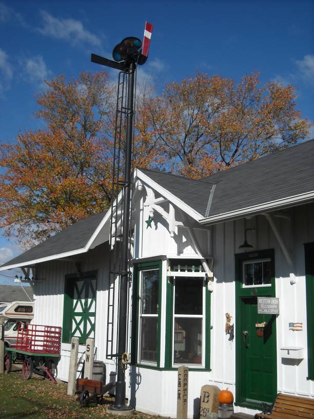

Matt, Attached is a photo of the train order semaphore i made up for my depot using parts.I don't know if any of this would help for the application you want to do or not? For the pipe connecting control rods i used 1" pipe.Since my signal pole was 27ft. tall not including the bearing top mount with specatacles and light box i went to Lowes bought 6 - 10ft. pcs.of 1" pipe with coupling pcs. to connect them together for the total desired length wich i needed.Where the pipe rods mount to the actual cast spectacle bolt stud,on the ends of the pipe i welded some end pcs. of old RR brake rigging rods with eyelets from the local scrapyard.As i mentioned i had to make the proper bend near the end of each pipe where they mounted to the spectacle to make them operate right.
My ladder has 4 support connecting brackets to the main signal pole.On the backside end of each bracket i welded a 3" long pc. of flatstock bar with a 3" pc. of 1 -1/2 inch pipe welded to the end of that as a sleeve for the 1" pipe control rods to slide down thru.So on each side of the ladder there are 4, a total of 8 all together as holders/sleeves for the pipe rods to slide thru.Since i don't have my control arms inside the depot and instead outside on the actual pole. About 4ft. from the signal pole base i attached pipe elbows to the 1" pipe control rods and made handles that screwed into each.About at that location are also my bottom 1 1/2" support sleeves on the bottom ladder bracket,i drilled holes thru them,then where each of the 3 positions were on the semaphore pipe control rods i drilled holes thru the 1" control rod pipe.I then attached a small chain to each side of the bottom brackets and attached a pin.So whenever i want to change positions on each semaphore blade all i do is lift up on the pipe control rod handle and insert the pin into the hole for whatever position i want.
I did not extend my ladder all the way to the ground for the sake and reason of keeping my 4 year old grandson from climbing up the 27ft. pole! I have a shorter 10ft. tall RR signal by my garage with a ladder to the ground and i have already caught him trying to climb to the top of that one! I'm planning on making up another depot train order semaphore this next year for our local rail trail for our Monroeville,Ohio LS&MS/NYC depot wich were restoring back to it's 1919 NYC RR evaluation photo appearance wich will be our trail headquaters,meeting room and rail trail interperative museum.
The one i've made up for my depot and the one i'm planning on doing may not be factory original RR material but they do have some real parts and give the look of what was once was used by depots years ago.
