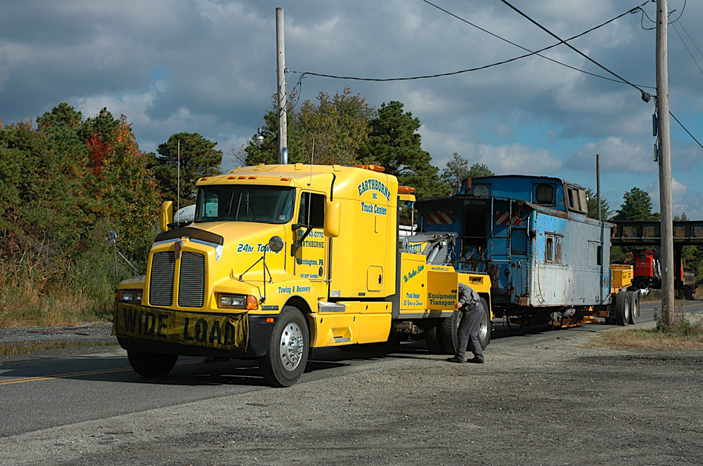

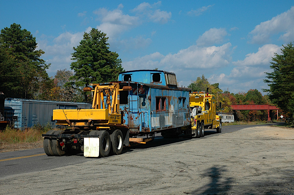

The easiest way without the cost of a crane is to use a heavy duty towing company. The caboose body without trucks (even one with a cupola stays under the height. and normal weight limits.
Did this with my caboose on a 60 mile two state trip from live rail to backyard. Total cost was around $5000 which included the various permits. Yes I supplied a lot of the labor on both ends - a tractor and backhoe and lots of oak block cribbing. I had to do it this way as there was no excess (over 13' 6") hiway route available so a trailer was out of the question
Rich
