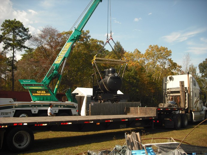

Don't ever rule out the role that a heavy duty tow truck can play in moving rail equipment. The modern tow trucks for moving big rigs are a marvel of technology and much cheaper to bring in than a crane. One was recently used to move my Porter. Granted, the locomotive was only 7 tons, but it was lifted like it was nothing at all. So, I would strongly suggest that anyone looking at a move make some calls to the local big rig towing companies. Tow trucks are not what they used to be.
For the Porter we used Battalini Brothers in south Jersey. They did an outstanding job. Highly recommended.
I understand an outfit called Staten Island towing does nice work as well.
J.R.
