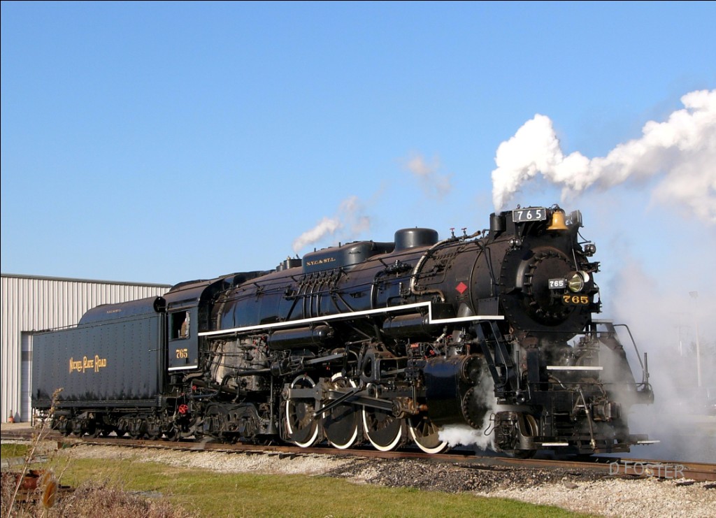

What is the source of steam emitted next to the exhaust stack and numberboard in this photo?
A friend from school is curious, and now, so am I.

Two different individuals have informed me it's exhaust from the air compressor.

They must have added that, it used to exhaust thru the smoke stack thru the smokebox, perhaps the recent overhaul caused this.
I wonder as the exhaust could cause a backlash in the smoke box and the fire heating and smoke. Probably a smart move.

I also appears they used some type of muffler arrangement. I have seen a few locomotives whose compressor exhaust does not go through the smokebox and it is quite loud.

The device appears on NKP Berks from their in service days.

Indeed. I remember the external air pump exhausts on 759 back in the day. It was often audible over the track noise when the engine was drifting at speeds under 30 mph. It was much louder and sharper (as I recall it) than the sound of an air pump exhausting into the smokebox.

The 30" 2-8-0 I worked on had it's exhaust routed internally, was originally an exterior with a muffler. Made it very tough to fire, every time the compressor hit it was like a birthday candle at a party. Not sure if that would effect a locomotive this large but there is a reason to design I've found.

That is where the air compressors exhaust, and it goes through a muffler so it is not so loud. It makes a more pleasing muffled sound, Striaght air compressor exhaust is loud.

You can see the 2nd steam exhaust working here.

Is there any specific reason why the air compressor exhaust would be vented in this fashion? From a engineering, operational, or maintenance point of view.
I have found the air compressor exhaust to provide a convenient slight draft on my fire while a locomotive is still. However, if it's exhaust is not vented through the smokebox this air compressor induced draft should not exist.
My initial guess is outside vent eliminates a pipe from the hot, particulated environment of a smokebox.
