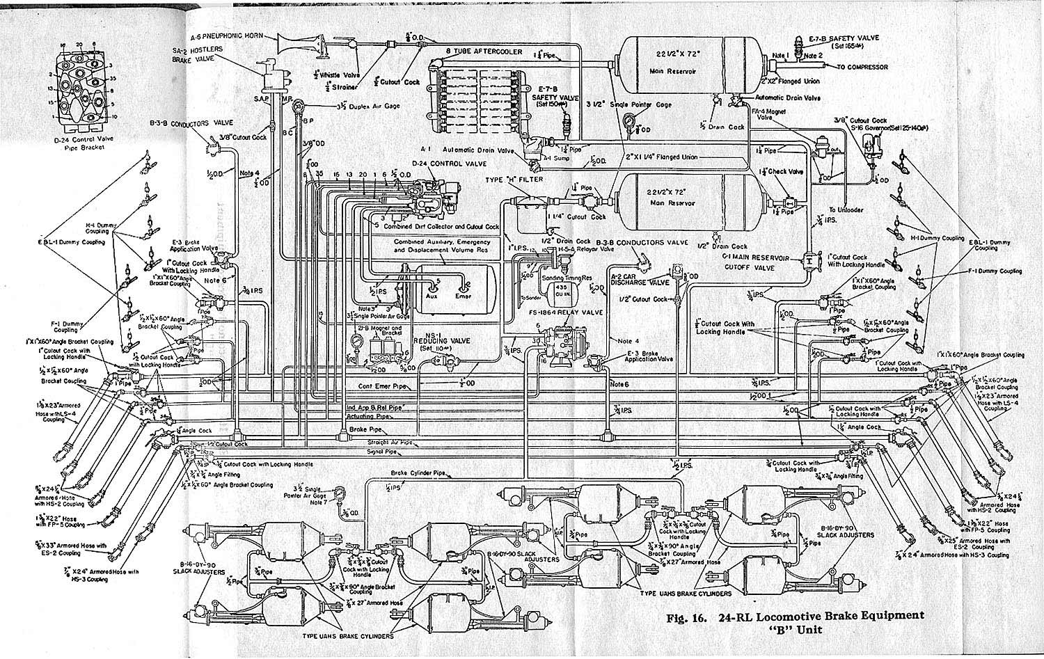

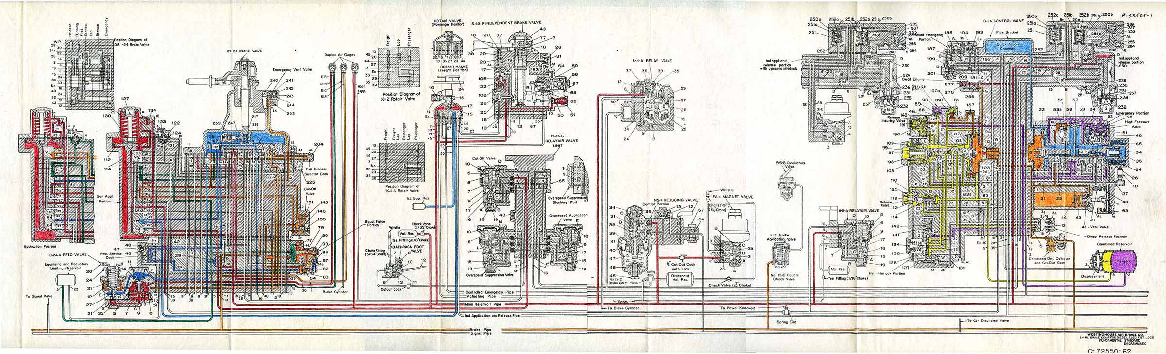

Some people say you can find almost anything on the internet nowadays. But I often find nearly zero when it comes to reference items for historical railroad maintenance. Too odd a topic I guess. Well, a couple days ago, while working a night shift I spent quite a bit of time trying to find diagrams or information to trouble shoot a 24RL brake system. I found some 26 brake information (actually NYAB has some good pdf's) and even a 6BL system but very little about the 24RL.
Granted is is an antiquated system but a lot of us deal with antiques. Anyway since I knew I had some information at home I thought maybe someone besides me might need to reference some diagrams.
The one which was hand colored by a BAR employee years ago come with some papers given to me when the ARHS bought BAR F3 #46. I have often looked at it almost as a work of art. The other is a diagram for a 24RL brake system for a B unit. This was not found in every 24 brake manual.

File comment: B unit brake diagram
File comment: Hand colored 24RL brake diagram from the BAR
