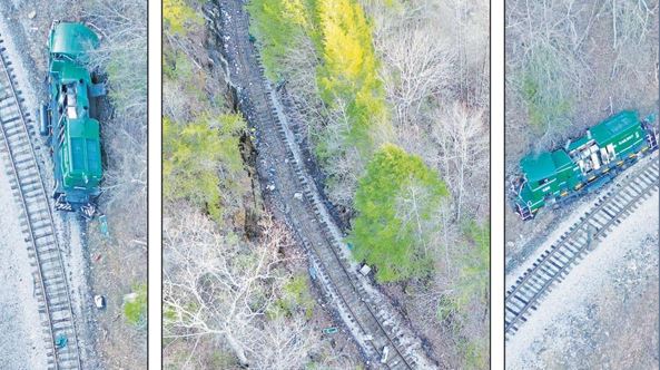

Reports out of Stearns, Kentucky are that the Kentucky and Tennessee Railway's (Big South Fork Scenic Railway) SW9 #106 somehow got away from its crew and ran away unmanned down the railroads steep gradient and leaped a curve embedding itself into the side of the mountain.
Pictures coming out show the entire fireman's side of the locomotive has been destroyed and its been reported that the wreck was severe enough that the prime mover and the generator actually broke their mounts. It would appear the loco is totaled.
Engine was running light and no other equipment was involved.
Photo sourced from public Facebook group (not mine).
