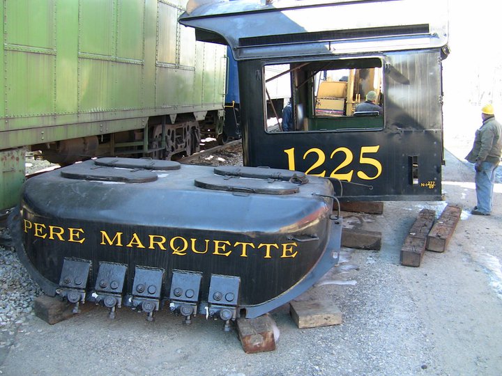

Should have posted this Sunday of last week, but have just totally forgot. I think the picture says quite a bit.
Edit: The sandome has been off for a few weeks now, it was the cab that was removed last week.
File comment: Two major obstacles have been removed.

Sand dome question: There are 5 ports on the sand dome. Is the 5th port an air intake or is it a sandline going to the trailing truck booster? Thank you for tolerating this non preservation question.
Tom P
 Post subject: Re: Just a weekold update...
PostPosted: Thu Feb 24, 2011 3:22 pm
Joined: Thu Jun 11, 2009 11:07 pm
Posts: 150
Tom Parkins wrote:
There are 5 ports on the sand dome. Is the 5th port an air intake or is it a sandline going to the trailing truck booster?Tom P
1225 has one sander in front of each driver, plus a fifth one behind the main.
Walt Lankenau
PostPosted: Fri Feb 25, 2011 12:56 am
Joined: Tue Mar 02, 2010 5:03 pm
Posts: 261
Location: SE, Mich.

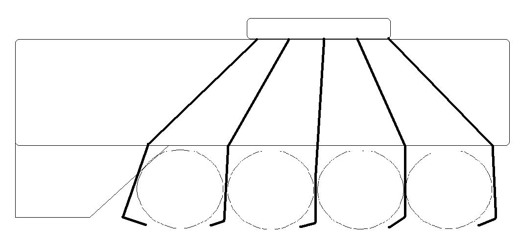

Tom P
Attached is a very basic diagram....basic is the key word...

Is that rear sander used primarily for back up moves? Can it be independently operated?
PostPosted: Fri Feb 25, 2011 12:30 pm
Posts: 261
Location: SE, Mich.
The fifth sander is for back-up moves. I assume it can be used independently.
