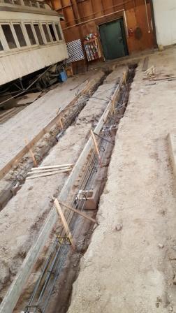

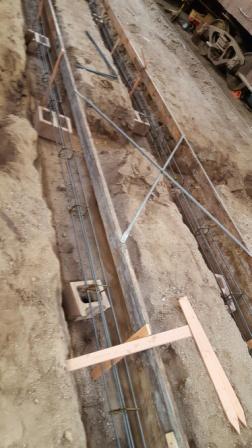

Starting with the purchase of an old gym building in 1980, the past 36 years has lead to many changes. First the wooden floor came out, then ties and rails went in for three tracks. Lots of grading outside and other track work was laid to allow direct access to the San Diego & Arizona Eastern Railway at Campo Junction - now called Rose Junction for a long time member, volunteer and benefactor. Little by little, dirt was replaced with concrete. As these two photos show, track 13, the middle track of the Shop Building, is now being replaced with concrete grade beams to support the rail, and will be covered with a concrete slab. Our volunteers appreciate working on concrete rather than dirt.
It's "All ahead slow" for the all volunteer museum, but, slowly and steady, work progresses on MANY fronts.

Yes, Steven. The Museum purchase the old gym in 1980, and we immediately turned it into a Shop Building. Over the years, we have been replacing the dirt floors with concrete by removing the wooden ties and installing concrete grade beams to hold up the rails. This is the second track we have completed this for - one more track left to do if we want all concrete floors. Right now, track 14 is used to store wooden cars inside, so concrete floors there aren't a high priority. We have a pit on track 12 and now a 160 foot long working area surrounded by concrete for track 13.
We have also just completed a lighting upgrade with "T-5"'s, which work great.
