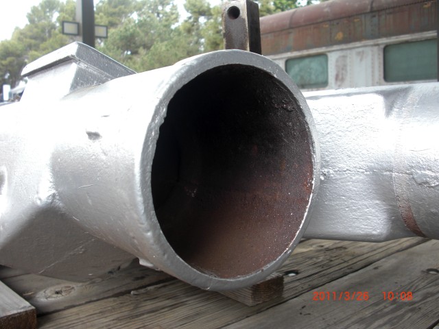

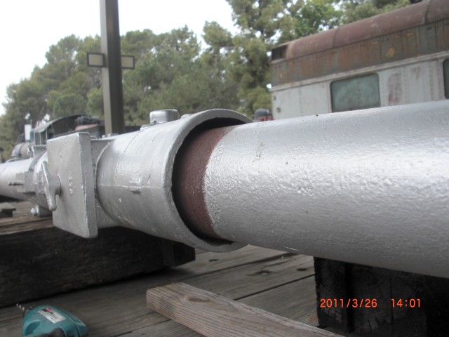

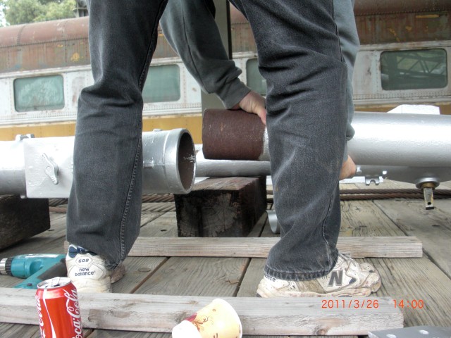

We moved the mast from the work area over to the flatcar where we'll do the final assembly and then transport them to the work site. I took some images of the pipe pieces and we loosely assembled so you can see the joint gaps we are dealing with.
There are no set screws, or anything else to help fix it into place.
Greg
File comment: Here are the pieces assembled, but not centered.
File comment: Here we are sliding the mast sections together.
File comment: Casting on the lower mast. This casting also holds the bell crank for the lower semaphore blade as well as supporting brackets to hold the light fixtures.
Greg Ramsey

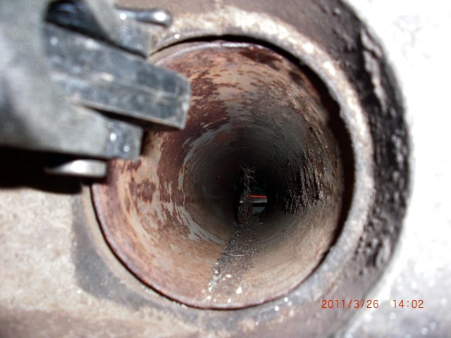

One more image from inside the mast.
File comment: Just for fun, I shoved the small point and shoot camera inside the service cover and pointed it up the mast.

The photos are great ! Here are some more thoughts : Take those cast iron covers off of the bearings (Large Wing Nut and cast iron cover.) You need to lay the signal flat with that opening lying down . It is important that both bearings are lying exactly the same way, or your semaphore specs (casting with the lenses and blades) will not line up correctly.
I could email you a photo of a SP semaphore bearing with set screws, or another way that you could line up the mast inside of the casting would be to place nuts just inside the casting between the mast using them as a spacer before you pour in whatever material you decide to use.
I do have US&S catalog pages if that would help, feel free to email me offline.
