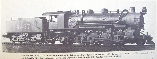

Here is the photo in the Prince book.
Westside Models / Samhongsa produced the MS class 2-8-2 + 2-8-0 in HO scale.

Interesting to note the delivery piping to tractor. There are two sources - the front one obviously after the superheater (Type A), and then the one popping up out of the boiler behind the steam dome. I'm guessing the throttle to dry-pipe connection resembled an inverted "T" instead of an "L." Since the G's were saturated engines, I'm guessing the used the combination of superheated and saturated steam to get a bit more out of the tractor, but that's just an educated WAG.
Mike
Kyle,
Didn't you post some photos somewhere else of these things? I found one of the 2-10-2+2-6-2 beasts...
