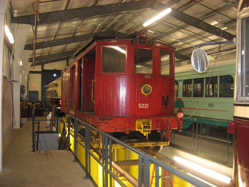

PostPosted: Sun May 08, 2011 2:31 pm
Posts: 2565
We have both a bridge pit and walled pit. Someone's regs required that we install a removable railing system to prevent falling into the pit.
Wesley
