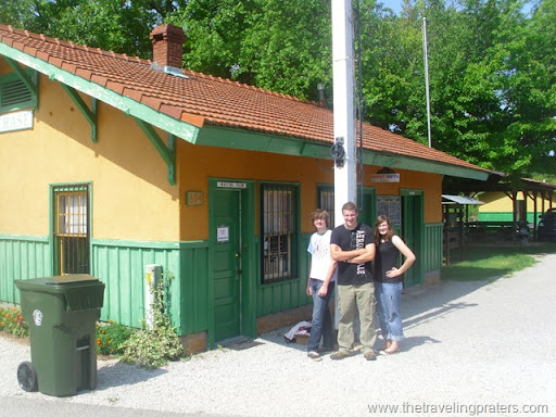

An internet search turned up this restored wooden orderboard at a museum in Chase, Alabama. It looks to be the same style as the signal in Meridian.
http://www.northalabamarailroadmuseum.com/restored.htm
http://lh3.ggpht.com/_vWpBhbmqn1A/TEiyQRrpReI/AAAAAAAABcM/lwnkppZm-MY/northalabamarailroadmuseum0296.jpg
