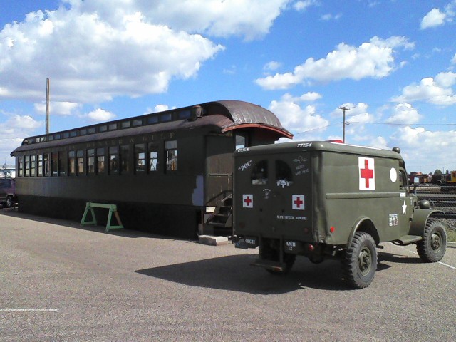

Does anyone here have a recommendation on a good lifelike gold paint for lining ? It will be over an oil base, i dont fancy doing 212ft of gold leaf just on one side let alone two sides and two ends.
Today we had a unexpected visitor, and almost the same colour (if he varnished it)
Mike Pannell
Car 57 Cheyenne
