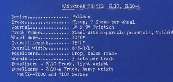

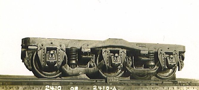

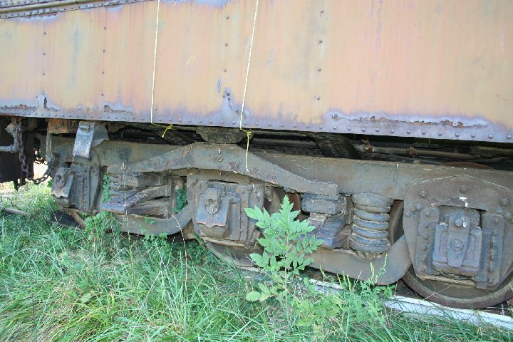

Thought I would offer something on the subject... I have a book ( actually a ring binder ) from the PRR...It is an original PRR shop book with black and white glossy photographs of PRR and Pullman trucks... along with a data sheet showing information on each type of truck found on different PRR and Pullman cars.... In regard to the 2410A trucks, I thought this information shown in the photographs would be helpful.... The color truck photograph is an example of this truck under Pullman ex Nickel Plate business car # 3 ( later known as the Quickstep ) ...
Hope this might be of some assistance

Yeah, that was my impression, the shop men identified the truck from its attributes. Note in the table reproduced above:
Equalizers - 2410 truck, light weight
Equalizers - 2410-A truck, heavy weight
Ask again on the PassengerCarList, specifically what the difference in the equalizers was... somebody knows. As I recall, the difference is 1/2" in the thickness of the steel the equalizer bars are cut from, but I don't remember the exact dimensions. Keep in mind that the PCL is first and foremost a modeler's list; someone should know the difference, but 1/2" is only .006" in HO scale, imperceptible to the modeler. You need to explain you are researching the prototype to get the folks who can help in the proper frame of mind.
Hopefully the Pullman Library has drawings, but most likely has to pull the drawing list for the specific car to find the drawing; Pullman may not have catagorized generic trucks.

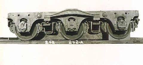

here is another example..
the Pullman 242 / 242 A truck
Dean
