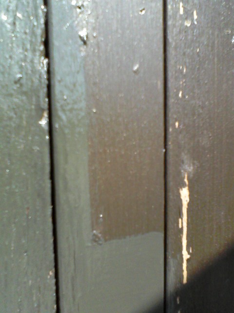

We are having a devil of a job finding anyone that can match a true Pullman green window frame that we have and give us oil based gloss paint.
We had a quart made up succesfully in Latex just for patching initially but the oil based match is being a huge pain. The analysers at various locations throw up different formulas that are either too light or too dark.
Anyone have a Sherwin Williams formula we could try ? Or anyone else's
Picture illustrates our latex formula, which is far nearer the right shade and the adjusted (from brown !!) oil based gloss which is way too light !!

Thanks everyone, Sherwin Williams here in Cheyenne spent two hours matching and tinting and came up with the best match yet, so we are good at last.

Thanks chaps these replies have been fascinating, i agree that matching is vital and i intend to be really anal about it ! After all i have to live with the car and tell its true history. We have great original paint under the hoods but its tricky taking those in !
Pullman green was beyond the capabilities of the computers at most paint stores, most people swore it was brown that i was showing them until you told them to take it outside and in the sun it glows a beautiful olive green.
Pullman must have had strict controls surely on mixing paint, otherwise you would have all 5 cars going to the DT&FW for instance in differing shades ?
I went down to the car tonight at dusk and put some new paint on...was scared to see it looked truly brown.... however light was playing tricks as the sample i brought home looked green in certain lights....so we must be close !!!

I guess we assumed Pullman green because it was built there and we have found tons of green all over the car in unmolested areas. Anyhow we have a great match now and we will post the results and if anyone else needs the formula we have it.
It was matched to a top rail of the window frame that was hidden behind the upper window so it was clean and unnaffected by the light.
