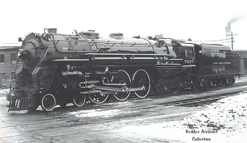

With all the recent talk about Chinese steam.... , afew years ago, I had read about a group in the east coast looking into the possibility of building a brand new New York Central J1 Hudson. This project was on the same lines as the A1 Trust in the UK, who recently built a brand new British Railways A1 class 4-6-2 ( see link : http://a1steam.com/ ) Does anyone know if thie NYC Hudson project ever got off the ground and if it did, who is doing it and what is the current status? Thanks - David Notarius, London UK (ex New Hope Pa)
File comment: NYC 5200, the first Hudson

Not being an NYC fan, I wouldn't have a "dog in this fight", but would the replica group want to build one like that in the photo, or the "Art Deco" (Dreyfuss?) model that many of us associate with the 20th Century Limited?
Bob Davis
Southern California
