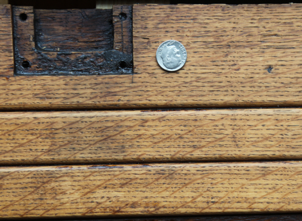

Much of the interior of the Chapel Car at the Northwest Railway Museum is oak -- 115-year old oak.
The picture is of a portion of an interior door frame I was cleaning of its varnish with denatured alcohol and much elbow grease. Look at that grain compared to the junk we can buy today. Last year I was working with the 100-year old Honduran mahogany of the upper oval windows of the SP&P coach also undergoing renovation here.

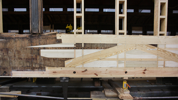

About a month ago I posted a picture of the gaping hole in the side of the car because of the door cut into it when it was a diner. The picture below shows it fixed. The door was to the far right.

As far as your complain about wood quality, I can assure you that if you look hard enough (meaning NOT your Lowe's, Home Depot, or 84 Lumber, but specialty sources), you can find that quality of wood--and pay a premium for it.
I'm aware of one steam thresher show where part of their "income" is running their vintage sawmill not for random demonstration, but custom-cutting carefully-chosen logs for specialty projects--building restorations, furniture, etc. This requires the lost art of looking at the wood grain once you're "inside" and seeing if you can still make the cuts you want, and how and where. I'm told quite a few trees that were felled in the recent tropical storms were salvaged and are aging, awaiting a turn at the saw next year......
