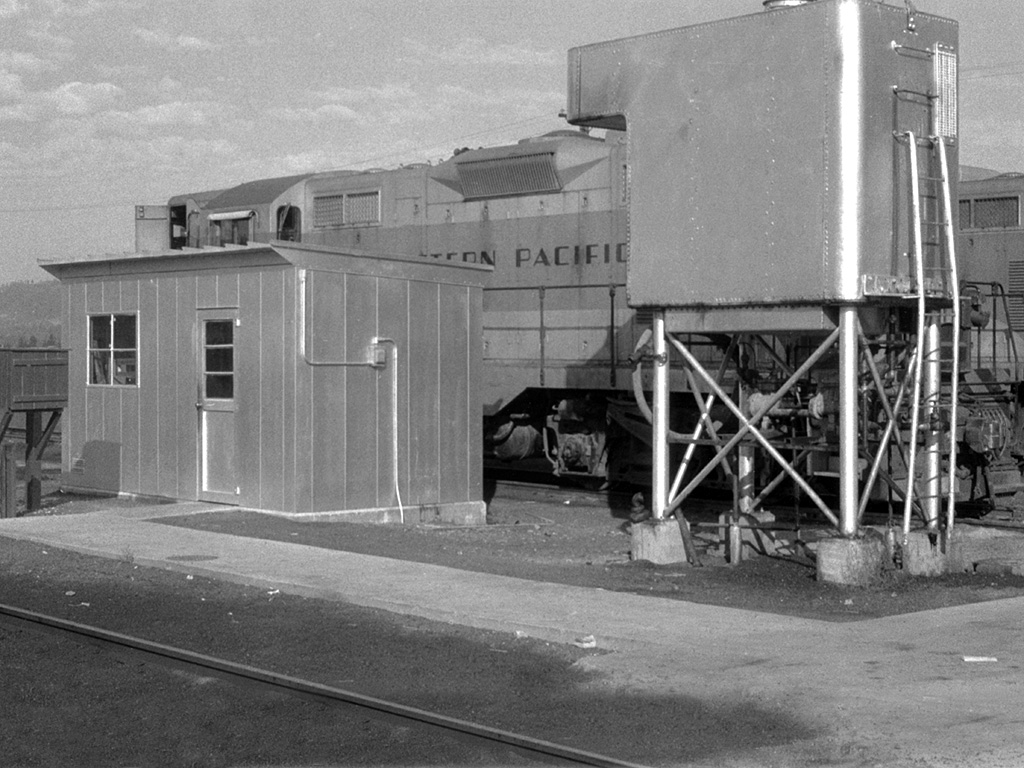

I am trying to reconstruct the history of a number of structures in a railroad locomotive and freight car servicing facility and I have some questions some of you may know the answers to related to the servicing of solid bearings.
I have a engineering drawing of what is described as a "Lubricating Oil Tank". It was made in 1949 from the 2,400 gallon oil tank in the tender of a Western Pacific 0-6-0 steam locomotive. Its use is described in the drawing as belonging to an adjacent "Waste Soaking House". I have a photo of the tank and the "waste soaking house" but the photo doesn't reveal a lot about what exactly how it was used (see attached). The drawing of the tank indicates that it had a steam-supplied heater coil, presumably to keep the oil viscosity such that it could easily flow in cold weather. The drawing shows no pump apparatus of any kind, but it looks like there may be one underneath the tank in the photo.
The drawing, incidentally, is from the Motive Power Department, not the Mechanical Department, but many WP drawings of freight car related components came from the Motive Power Department so that isn't very telling.
Obviously a Waste Soaking House was where the cotton/wool waste for solid bearings was immersed and soaked in the lubricating oil used in the journals. What I can't figure out is how exactly this oil tank fit into the operation there.
Was journal oil generally purchased new or was used oil ever used for this purpose? If used oil was used, is it conceivable that it was the used crankcase oil from diesel-electric locomotives? Or might the journal oil, if used, come from some other source? This facility's main purpose was to service diesel locomotive so there was, presumably, a regular supply of used crankcase oil.
The fill hatch for this tank is at the top, which is about 16-feet off the ground. Would 55-gallon drums of oil, whether new or used, have been forklifted up there for unloading, or, if bought new, would oil come in tanker trucks, or tank cars, and be pumped in from ground level (typically)? Again, there is no pump indicated in the drawing, but there looks to be one in the photo. The drawing was from 1949 and the photo from 1955 so perhaps a pump was added later?
Any insight into how this worked, even if your knowledge isn't specific to the WP, is much appreciated. All this solid bearing stuff went on way before my time so I don't know a lot about how it worked.
Mike

Don't know this specific facility, but it is likely that the oil was pumped into the tank in bulk rather than lifted in by small batches. There may be an inlet under the manhole cover in the slab in the photo. The elevated height of the tank suggests it drained by gravity to dispensing hoses in maintenance pits nearby. Only truly threadbare shortlines would use old dirty oil in journals. I'd also assume a supply of saturated waste ready to go was generated and held in the building for repacking purposes, probably using oil from the tank as well. Good luck finding documentation.

On the left side of the tank at the bottom you can see a large valve with a large hose coiled next to it that was probably used to connect to tank car or truck.

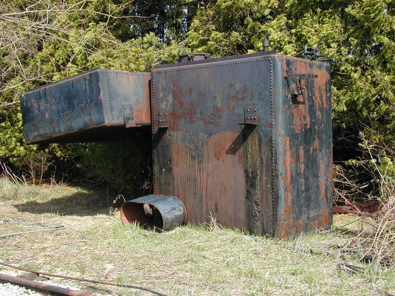

I'm curious about the shape of the tank. It looks like it could have been an oil tank, inserted into a coal bunker on a steam locomotive tender? The top left corner looks like it could have extended over the water space. Anyone else have the same impression? The railroads were among the earliest recyclers, right?

I get the same impression about that tank. I believe the CNR did the same when they converted a number of their engines to burn oil- fit a tank into where the coal bunker used to be.

The "inches equals gallons" cast data plate can be seen on the right side of the tank; this would have faced the cab of the steam locomotive. It sure looks like an oil tank pulled from a steam tender. The WP was a pretty thrifty road and even made some steam generator cars from 4-8-2 tenders (ex-FEC engines).

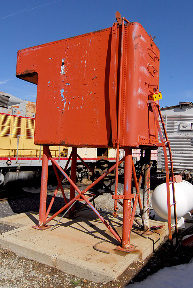

Here is an oil tank that was used to adapt a T&NO (SP) 4-6-0 to oil. This was the engine that was displayed for years south of Monee, IL at the Thompson Vineyard. When it was moved to the Roosevelt Railroad in Georgia as a display item they left the oil tank behind.
More photos here:http://home.earthlink.net/~stevekraus/monee.html
