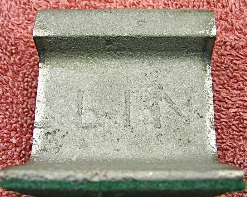

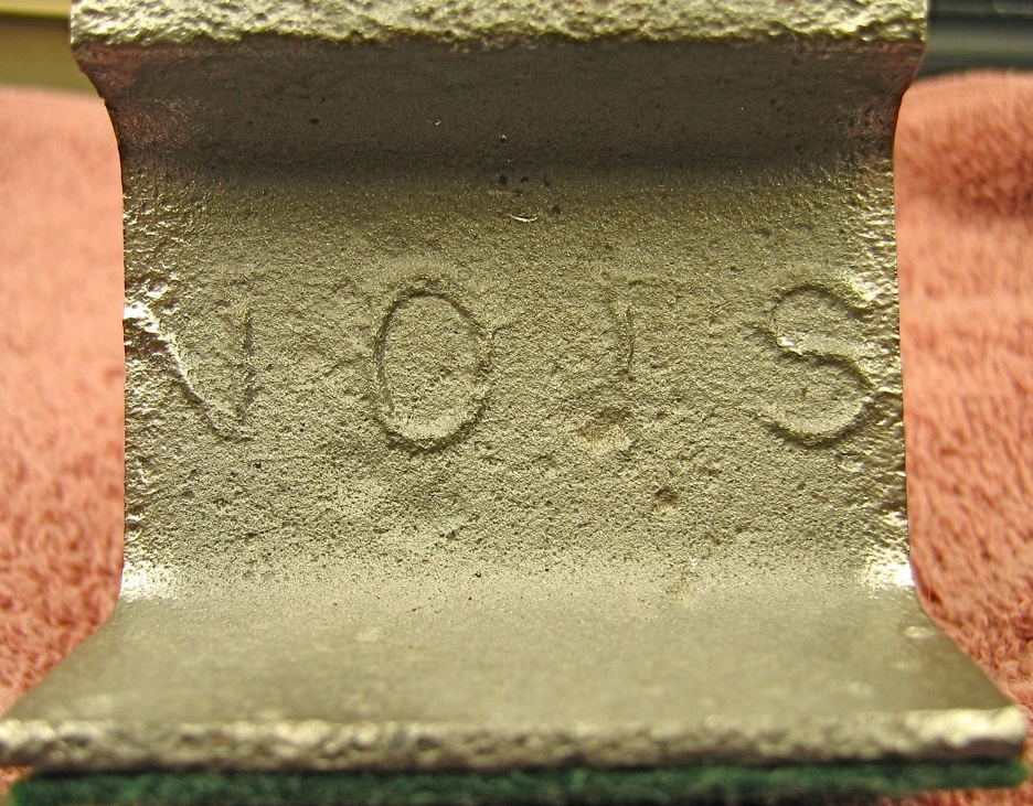

I have two souvenir sections of the rails on which streetcars ran here in Kearney, NE from 1890 to 1895. Would anyone have ideas on the meanings of the letters cast into these rails? I believe they were about 15 pound rails.

They appear to be portions of "ILLINOIS", which probably would have been the location of the mill where the rail was rolled.

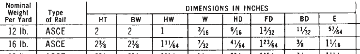

Thanks to all for your very helpful information! Yes, I know 15 pound rail is very light. Kearney’s streetcars were small, and were first horse-drawn. Later they were replaced by electric cars quite similar in size. The rail sections I have each weigh about one pound, and are 2.4” long. That would mean 15 such sections in a yard, so that’s how I concluded the weight of the original rail. Mr. Schmidt, your suggested method is good, too.
Mr. Davis, thanks for the idea of the available charts. I found one from Unitrac Railroad Materials, Inc. There is no 15 pound rail listed, but the dimensions shown for 16 pound rail are exactly on target for my pieces. So I was off by only a pound, looks like. These images are taken from that chart. http://www.unitracrail.com/pdfs2007/Tra ... ection.pdf
Again, my appreciation to all who responded to my question.

Rolled by the Illinois Steel Company at the Gary Works in Gary, Indiana. In the great US Steel consolidation of 1901 Illinois Steel became Carnegie-Illinois.
