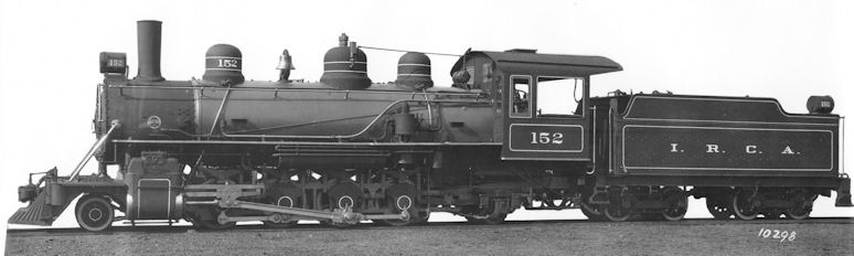

Here is the Baldwin builder's photo of IRCA 152 from the Broadbelt Collection. By the way, the print was obtained back in 1977 from Mr. Broadbelt.
Southern Methodist University -De Golyer Library has the BLW order record books. The index prepared by the Library of volumes lists separate entries for IRCA 150-151 (vol 79, page 76) and IRCA 152-153 (vol 79, page 82) . That volume is not yet among the volumes that have been made available on-line in PDF format.

Naw, the 194 has piston or spool valves and Walschearts valve gear.
What is interesting is that the photo of the 152 looks like it could have Caprotti gear; the steam chest doesn't quite look like a slide valve type, and I don't see the rocker that would be a trademark of Stephenson.
Equally interesting is that the "Caprotti" application seems to be made over a slide-valve cylinder block, in a manner similar to an "Economy" piston valve conversion kit. How many jobs were there like that?

Brian (Thanks) thats a great photo, its nice and clear, I might have to buy a big copy of that from the Broadbelt collection.
I've been studying the Guatemalan 3' gauge RY's for a few years now and I'm trying to make a comparison of all the Mike's that were Baldwin built and all weight nearly the same in all the roster notes. I'm thinking they might all use the same basic parts.
When I saw that blurry photo in the Cyclopedia I knew it was some sort of Poppet valve setup, but my first guess was Franklin. I had no idea that any of those (typical American practice, 3' gauge, outside framed) locomotives would had been built for the Guatemalan RY's with such an advanced, and somewhat experimental design Caprotti valve gear as far back as 1928.
This is easily my favorite locomotive now, Its really fascinating. I'll try to learn the story of how this thing came to be made and delivered with that valve gear.

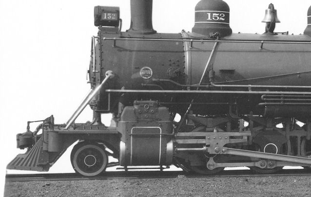

Do you men see (in Brian's excellent photo) a linkage leading to the steam chest that looks very much like a stephenson linkage would look?
Maybe the valve gear is driven by a single stephenson link or a small right angle gear box mounted on the front drive axle?
All the other Caprotti gear, that I've seen used either an eccentric crank off of the main crank pin, or a small right angle gear box mounted on a crank that is driven off the main crank pin and is centered on the axle center so it only contributes rotary motion to drive the gear.

To Loco 112:
What you say looks like a drive linkage looks more to me like part of the reversing mechanism. If that's so, the drive for the valve gear is inside the frames, coming off one of the axles. The Reading 4-6-0 was arranged that way.

Here is a detail view of the cylinder, etc.
It does look like some kind of poppet set-up.

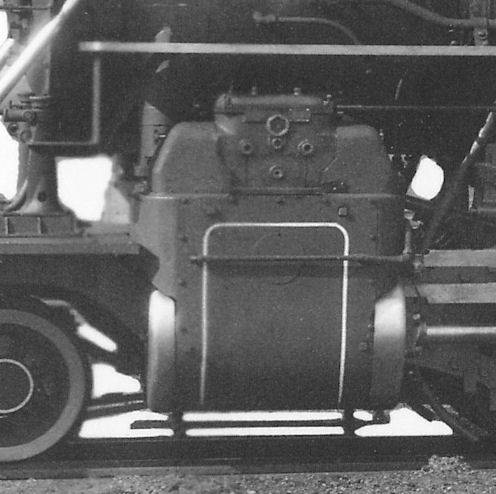

Thought I'd go one more and zoom in even more:
I think I've seen a photo of one of the 2-8-0's with a similar arrangement. I'm going to have to go looking for the rest of the Broadbelt photos.

Glad to see this blow-up, and yes, it looks like a poppet-valve job--my original guess looking at the original photo posting was wrong, looking at it here reveals the cylinder block is one meant for this application, not a modified slide valve job. A pipe running outside the block, combined with its shadow, looked like the step in a cylinder block that is above the cylinder on slide-valve engines with outside valve gear.
And I'm not absolutely positive, but it looks like the drive shaft for the valve gear from one of the axles is visible, an angled shaft coming out of the cylinders at about the level with the seam in the cylinders between the main cylinder and the cover for the valve gear. This is in between the frames, and mounted slightly off center. It looks like it might be going to the No. 2 axle.

Just took a look at the second blow-up, and I'm almost positive we are looking at that drive shaft behind the cylinders, angling down at about 30 degrees.
Any word as to what became of these engines, and is it possible one of them may have survived?
