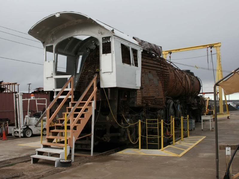

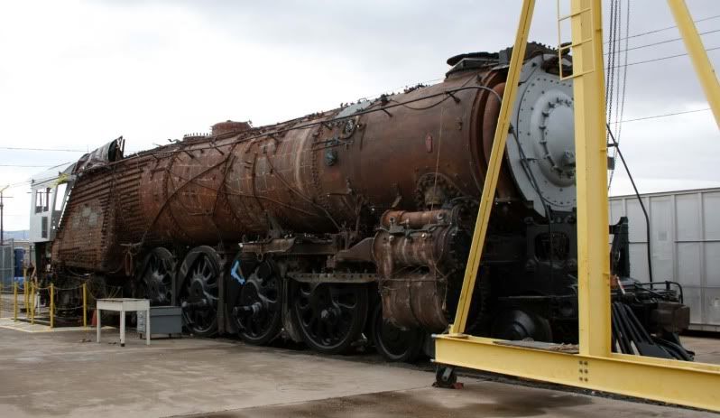

An unusually blowy, bitter day, in Albuquerque, was not enough to stop about a dozen men from showing up and moving forward with this huge Northern. Unlike many groups, with 100 members and 3 who do everything, this group generally brings 25 or more volunteers to the site each weekend.
Today, the men were awaiting word from Timken regarding the health of the roller bearings which had been sent in for examination. Santa Fe 2926 is an all r/b, oil fired locomotive (hear that, Ross Rowland?), last steam engine to receive heavy repairs prior to retirement, and was found to be in beautiful mechanical condition when pulled for the park. With that good luck under their belts, the volunteers went to work and started a new rebuild. Just about everything was perfect when they opened her. A projected running date is may be as early as 2014.

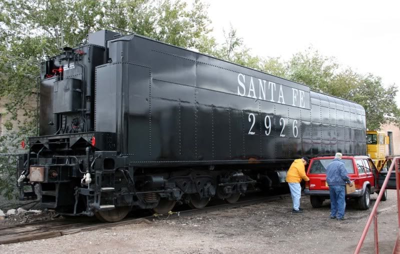

The tender is completed to Amtrak standards, ready to roll.

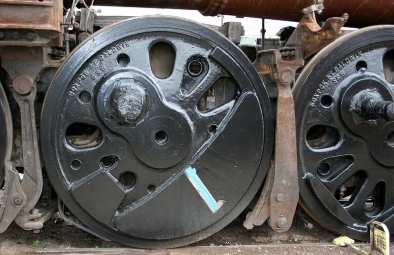

When it is said that Timken is examining the bearings, have the drivers been dropped and bearings removed? Can that even be done while the wheels still pressed on? And of course what would it be sitting on now? I presume any other roller bearings pale in comparison to the driving boxes. Unless they are looking at photos or something.

They don't have access to a drop pit, but it is believe the r/b's in the drivers are in good shape. Somebody from the group can answer better than I .

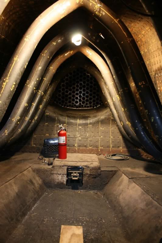

I should amend my comment: Not syphons but Security Circulators I believe.

Those are indeed the rod bearings that have been sent to Timken. If you check out the group's website, they have been working steadily all year long fabricating unique bearing pulling devices to get stubborn seized bearings safely removed from the rod ends and then packaged and sent off to Timken for inspection. The drivers have not been dropped. While they have built their own inspection pit, I do not believe it is equipped with a lift to lower a wheel set yet. It does have removable rails so I would not be surprised if they eventually have the capability to drop a set of drivers if need be.

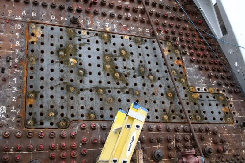

Firebox patches are coming along nicely and it looks like tubes and flues are being prepared for installation.
