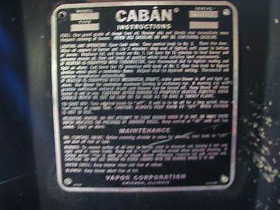

The only thing I could find online is this photo, and it isn't even legible, but I would bet you have seen this already. This question comes up from time to time, it may be that the plate on the stove is the only instructions ever received by the railroads. I did find a manual for a similar stove used in ships apparently: http://dickinsonmarine.com/Manuals/Dies ... 2011-2.pdf
The smell those things gave off, from both cabooses and camp cars, is permanently in my brain.

Here's a 1964 version of the instructions.
http://www.trainweb.org/oldmainline/prr/pg09h7xcaban2.jpg
I haven't found a manual online yet. I'd be happy to host a copy if someone coughs up a scan.
