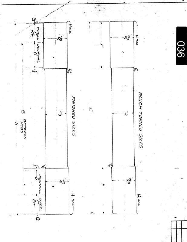

Gentlemen: Thank you all for your help. I must apologize for not making my original request for information a bit clearer. I was attempting to keep it short. Here’s the long version.
I have the good fortune of having a nearly complete set of the original ALCO parts drawings for my locomotive. I am missing only 4 sheets out of 557.
I’ve attached a copy of the axle drawing. According to the “card record,” dimension “J” on the #1 and #4 axles is 8 inches; on the #2 and #3 axles it is 8 1/4 inches. What made me think that these might not be the original axles is the fact that “J” didn’t measure to what the drawing calls for. #s 1 and 4 measured 8 1/16 and an even 8 inches, respectively. Those are pretty close. But #’s 2 and 3 measured 8 1/16 and 8 13/16 respectively. So, #2 is 3/16 smaller than spec, and #3 is almost ½ inch larger.
So, what kind of tolerances did they have in 1929? I can see that the center section of the axle probably isn’t critical.
According to the drawing, the axle is the “J” diameter until only ½" before the journal, where it has a radius out to 8 ½ inches. On my axles, about 2" before the journals, the axle is gradually turned down to the approximate diameter of the journals. Would this be something done later when the journals had worn down?
I measured the journals just inboard of the crown brasses, getting diameters of 7 5/8, 8, 8 1/4 and 8 1/8 inches for #’s 1 thru 4 respectively. If these are the original axles, then #1 appears to be worn too far. But, are these the original axles?

 Post subject: Re: Driving Axle Diameter
PostPosted: Wed Aug 14, 2013 2:06 am
Posts: 540
Location: Minneapolis, MN
If the drawing you posted is the correct one for your locomotive, then the original JOURNAL diameters are those specified (8-1/2 inches) for the new axle. Dimension "J" is not important as it never changes. The ONLY dimension that changes over time on the axle is the JOURNAL diameter. The journals can be turned and refinished as many times as neccessary UNTIL they are 3/4 inch undersize, at which point a new axle is required. In your case, the condemning limit for your JOURNALS is 7-3/4 inches. Please be aware that NONE of the journals on your locomotive will be the same diameter, even on the same axle. Some of the journals may be close to new and others close to condemning.
On the other hand, the outermost portion of the axle, the "Wheel Fit", is never changed because the wheels are almost never removed from the axle. If a new wheel is required, the axle is only machined if the wheel fit area has been damaged in some way. The new wheel is bored slightly undersize to provide the proper interference fit when it is pressed onto the axle.
When in use, these journal surfaces do wear and can get out of round, scored or tapered. When these conditions are encountered beyond a certain tolerance, the journals are turned and refinished and the driving boxes and brasses are machined or otherwise renewed to fit the smaller diameter journal.
Once a locomotive left the manufacturer, all maintenance and repair was usually the responsibility of the railroad. Locomotives almost NEVER returned to the manufacturer except for major modifications beyond the capability of the railroad's own shops. Sometimes new parts were purchased from the original manufacturer, but this was usually dependent on the capabilities of the railroad shops. All routine and heavy maintenance, including axle and crank pin replacement was done by the railroad's own shop forces.
PostPosted: Wed Aug 14, 2013 2:56 am
Posts: 497
Location: Northern California
How do you explain the 8 13/16" diameter journal? Maybe a replacement oversize axle to reuse existing drivers?
PostPosted: Wed Aug 14, 2013 7:09 am
From the other side of the country without any more information than what's been posted, it seems very likely to me that during the course of service on a logging railroad, probably toowards the end of tis career, a repair was made using an old axle from a larger locomotive that had been scrapped or stored unserviceable but was there and available, so........being a logging line in its last days, it got recycled. This is not uncommon.....what would be unlikely is having all the original parts still in one locomotive after a couple decades of industrial or shortline service.
These were tools to move stuff, and were expected to be used up, patched together, and discarded what the cost of extensive patching grew too high.
dave
