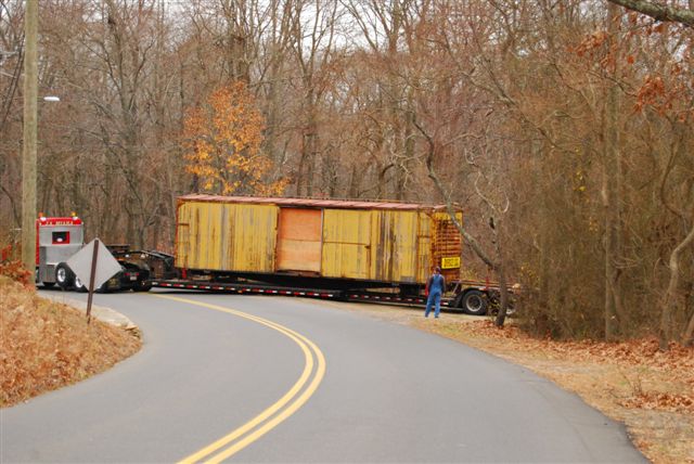

At 9:03 am on Bokum Road, Old Saybrook:
On a stretch deck trailer, 1912 Boston & Albany boxcar 39569 begins a journey to the Railroad Museum of New England at Chase Yard in Waterbury.

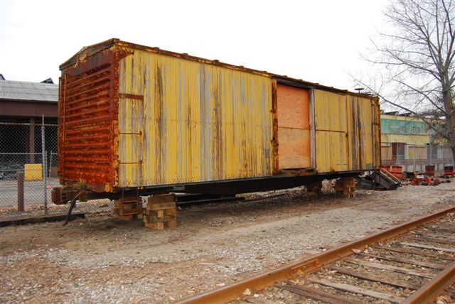

Boston & Albany 39569, after unloading at Chase Yard, Waterville, CT.
Car was built as part of Lot 312-B, numbers 39000-39904, by AC&F's Berwick Plant in 1914 (my first statement of 1912 was wrong). It is a 36-foot, 40-ton capacity car. The car has proper NYC Lines Vulcan 5 x 9 trucks with cast-iron wheels; trucks were brought to Waterville separately. Brake system was K-triple valve, never updated to AB. One door and the other one's door hardware are inside the car. On the "A" end, it has a type D coupler with a 9" knuckle, the "B" end is a type "E".
The warrantee stencil for the Murphy XLA Flexible Metal Roof is visible inside the car at the eave line; it expired in 1919 (a 5 year warrantee).
This appears to be the only Boston & Albany piece extant, except for the 1870-era "Eddy Clock" 4-4-0 at St. Louis.
This car and a number of others were sold after 1945 by their respective railroads to Norton Abrasives Co. at Worcester, Mass., for inter-plant service. About 1979-80, volunteers from RMNE (then named CVRM) selected and prepared for on-own-wheels movement, about 12 cars from the ones remaining at Norton (about 30 cars). Budget restraints and lack of space at Valley Railroad meant such gems as a gorgeous Lehigh Valley wood box were left behind for scrapping. The yellow color was Norton's paint scheme for their cars and they had Norton numbers.
At least 4 B&M 1929 XM-1 single-sheathed cars were saved and moved, 3 or 4 New Haven 36-foot cars (originally sold to NYNH&H by ace freight car salesman "Diamond Jim" Brady of Keith Car Co. in 1909) made the trip, one B&M 1918 USRA 40-foot double-sheathed car, the DL&W 36-foot double-sheathed car now restored at Steamtown, and a few others. It was the box car equivalent of Barry Scrapyard in the UK.
There may be an article about these Norton cars for RyPN, if I can figure out how to get it posted.

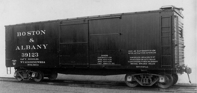

From the Steam Era Freight Cars website, sent along by my colleague Jon Chase. October 1914 built date.
Obviously, a lot of stencils to cut... but a very striking car when done.
