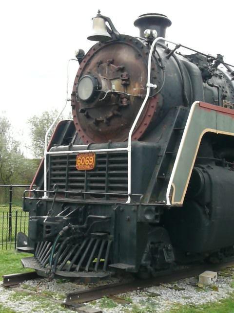

year, Bullet nose betty has had her nose removed for refurb and repairs. Many years ago, her numberboards were broken and missing allowing weather and birds to next inside the cone causing the steel on the lower cone badly corrode. We have contracted with a local special machine shop to undertake repairs and the nose cone should be back in a couple of weeks.

Not shot but it was getting pretty rough along the lower half. At some point years ago, someone had installed a metal patch on the lower half with machine screws and all that did was compound the problem. Our machine shop should have it restored back to original condition soon.

Thanks guys, yes the lower most corroded area has been cleaned off with needle scalers and the rest of it will be cleaned back to sound metal with wire wheels in a drill or grinder. We are using a anti corrosion primer on her and the front will be painted white as per original. Since that picture was taken, I removed the headlight for repair... Apparently at some point someone decided to install replacement hardware on the hinge and removed the bolts. They replaced these for some reason with a large turnbuckle that over time opening and closing, put pressure on the external light ring cracking it. We are hoping to get this welded and cleaned up and painted ready for installation.
If anyone knows a supplier of a new reflector we would like to hear from them. Ours was broken many years ago and currently there is only silver paint inside.

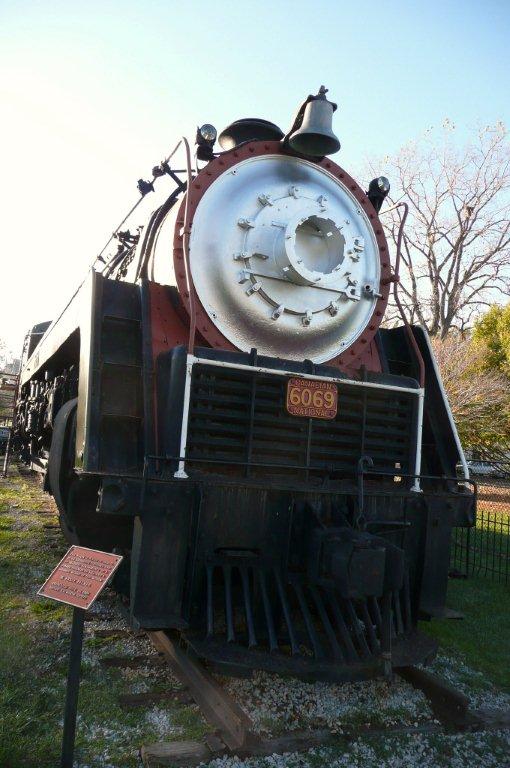

Update, the smokebox front has been cleaned back to good steel and primed and Painted. Number board light fittings removed for repair.

For the headlight reflector, you could use a metal salad bowl, polished down. I've got several I'd let you use but they might not be the right size, and I have dough rising in one at the moment.
